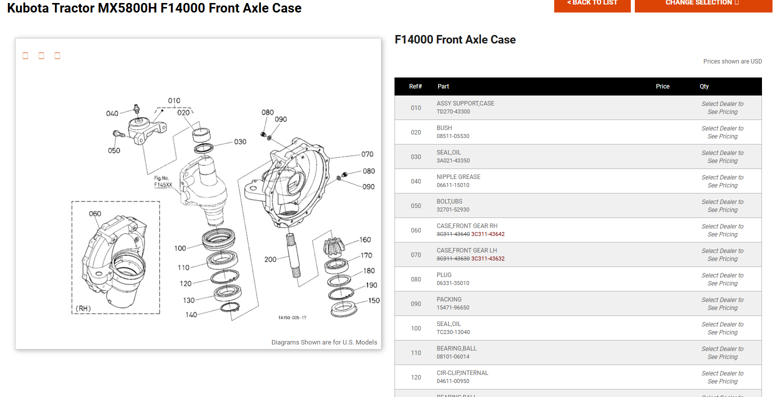

I would really appreciate it if someone could tell me how to remove the oil seal (item 100) from the Front Gear Case (item 60). It appears the seal is held in place by a metal ring that is driven/hammered in on top of it. How in the world do you remove the metal ring to get the seal out???

060 is the housing itself. Do you mean 100, which I call the "kingpin seal"?
Yes... Item 60 is the front gear case. Items 130,120,110, and finally the oil seal (item 100) are loaded into it. Then the Bevel Gear Case (Fig. No. F145xx) is pushed into all these items and Snap Ring 140 is installed on the shaft.
The Oil Seal has to be removed from the Front Gear Case before removing items 110,120 and 130. That's the point I'm stuck on. Sorry if I wasn't clear.

The seal is a cassette-style seal, a seal inside another seal. The metal you are seeing is the protective shroud for the seal.
I remove them by driving a square pry bar under the seal from inside the seal and turning the bar that pops out the seal using an adjustable wrench
There will also be a sleeve on the case from which you removed it. It will need to be removed before reassembling the assembly.

Thanks for all your help. I finally removed the seal, but what a hassle.
Tried the screw idea first but the seal wouldn't budge.
Tried the pry bar but couldn't get the pry bar between the oil seal and the bearing that was pressed against it.
Finally decided to run the screws through the seal and against the top of the bearing (have to replace it anyway due to metal contamination) in order to "jack" the metal top of the oil seal up (see photo). This gave me enough space to get the pry bar in and lever the top half of the seal out.
Lower half of the seal was stuck tight so I turned the housing over and used a metal bar and hammer on the bearing to drive out the bearing and the remaining part of the seal. No damage to the housing.
