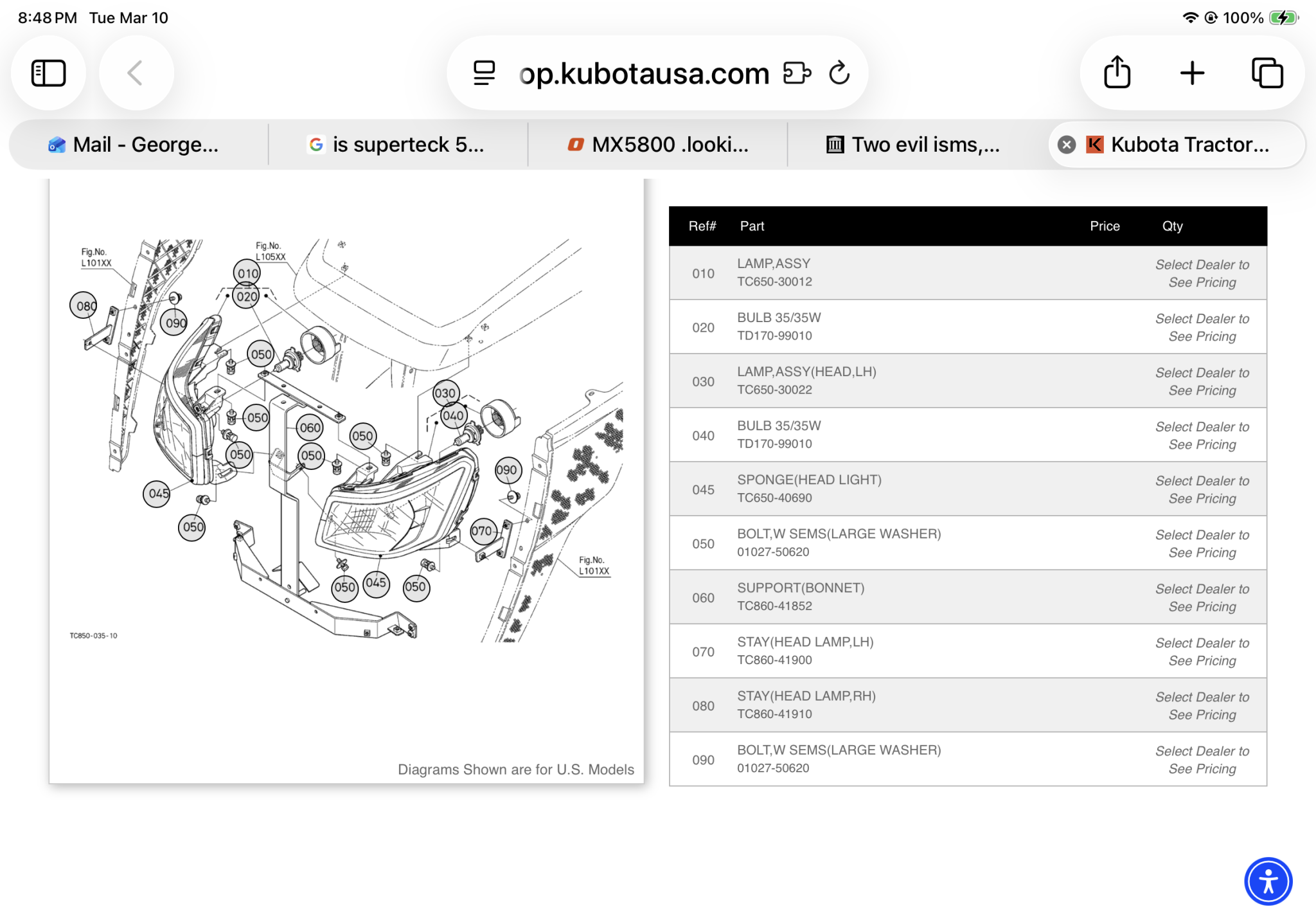

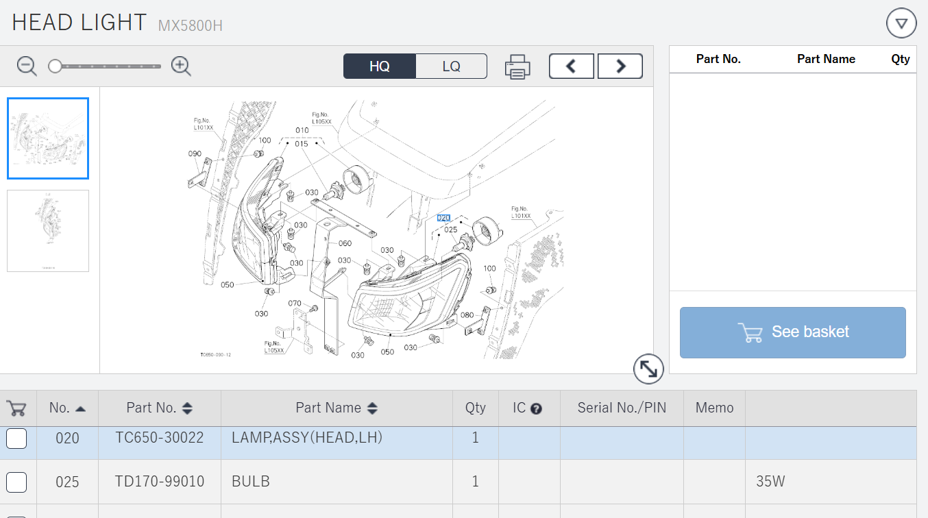

TC650-30022 LH
TC650-30012 RH
Is the entire assembly lamp (bulb) and lens
The lamp (bulb) is TD170-99010
35,197
10,397
Not according to KubotaUSA
Looks like you might not know how to read the parts drawings.
FYI: I've always gotten my part info straight from Kubota.
The key word is ASSY, which means assembly, which can be mutiple pieces, which in this case is the lens, housing, bulb, gasket and bulb cover.
6,618
4,002
Correct. I had read it to include those items incorporated into the item number…. (lamp, socket, holder)…. I should have Expanded the dwg and I’d have realized it included the lens, etc.
Thanks.
