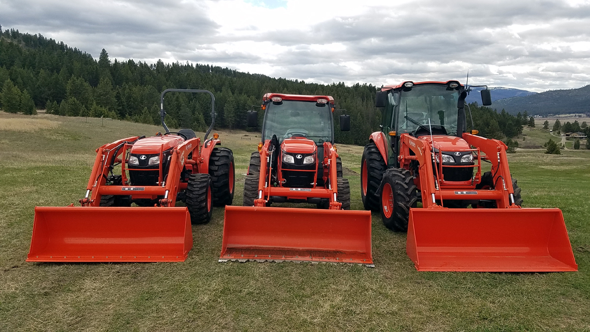

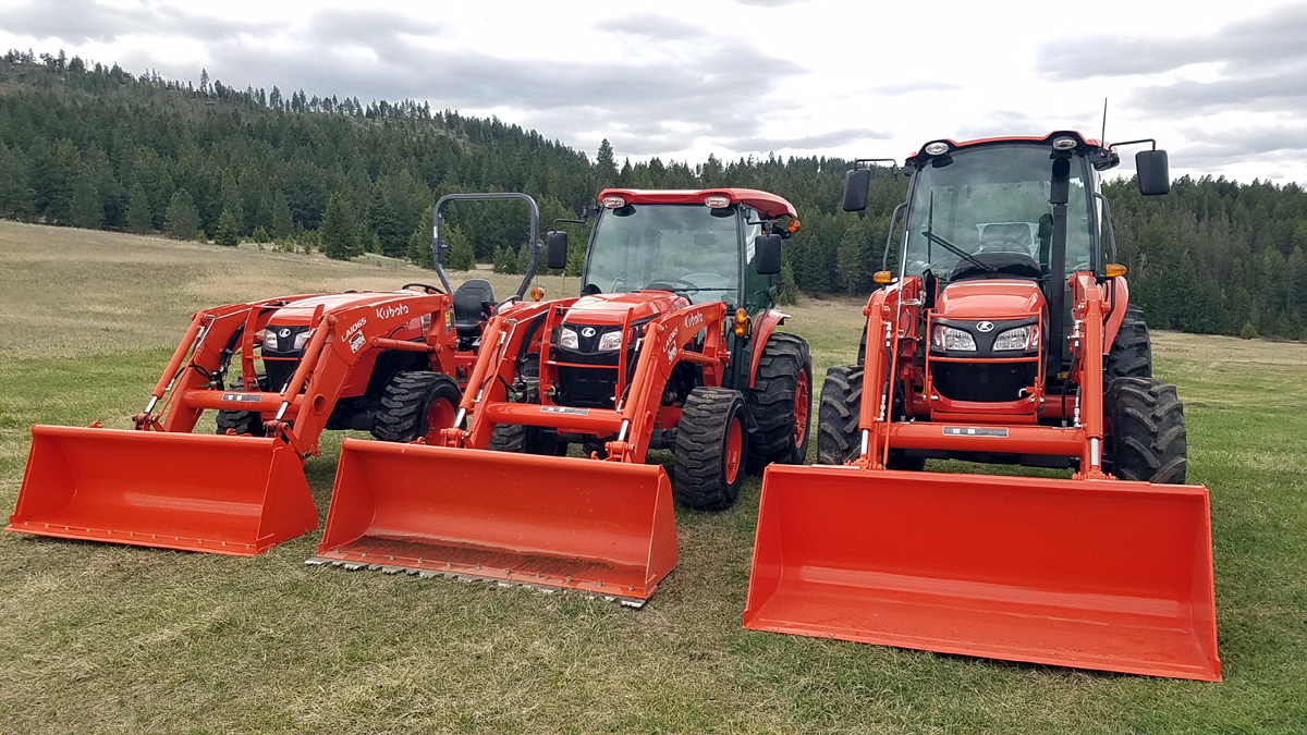

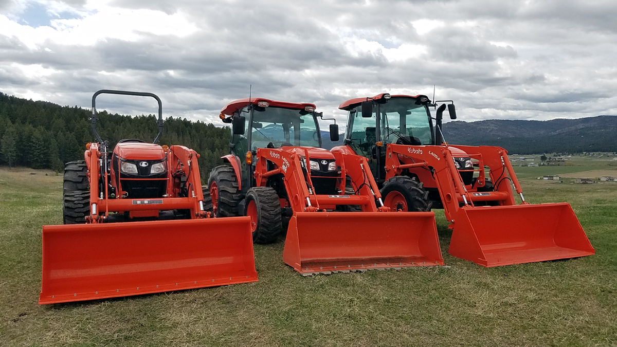

Here are some better photos showing the size difference between the (from left to right) MX6000HST, MX6000HSTC and M6060HDC. The photos don't really convey the size difference that well. The M is way more tractor.
I don't have fancy lawns to drive on but I haven't noticed a problem with the Ag R1 tires on the M6060 rutting up the ground much at all as compared to the R4 tires on the MX.
Thanks for the pictures. Yes these show the size difference. I see the decision was easy for you just get Both!

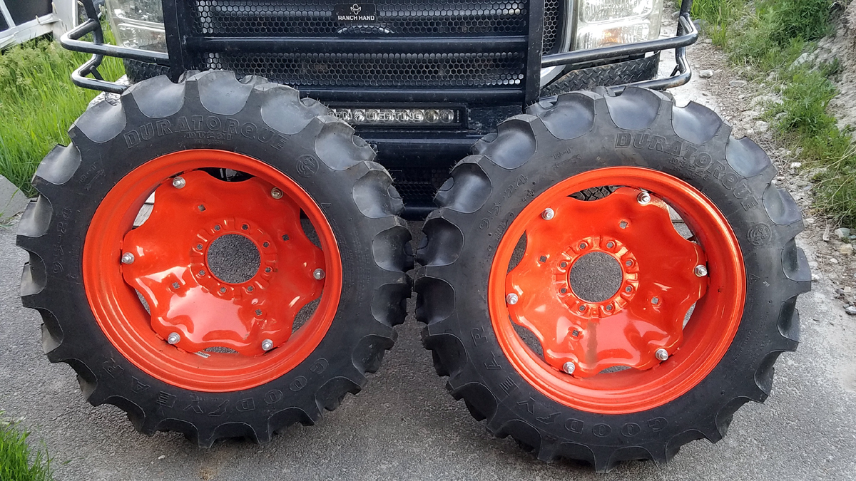

The rear tires are the 16.9-28 R1 Ags that came on the tractor. The front wheels/tires were 9.5-24 R1 Ags but I replaced them with 320/85R20 R1W Ags on 20" wheels. Much better looking, nicer riding, more stable and easy on the dirt.

The local Kubota dealer had the best price. I paid $1,549 for the wheels, tires and delivery. I've seen the tires alone for $900 each.
