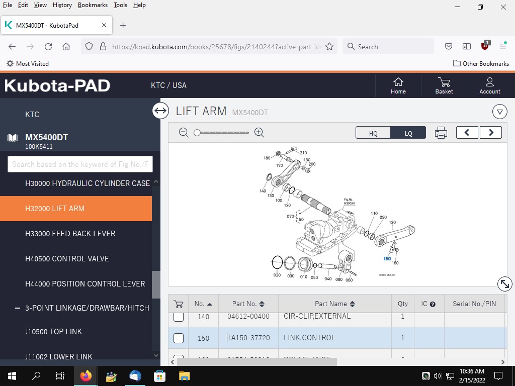

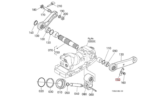

There should be a full-depth engagement of the splines in the arm, the nylon bushing and metal sleeve bushing should be further in, an o-ring seal between them. See attached part diagram.
The rockshaft moved right, withdrawing from the arm, bending the bolted 150 end plate. It became barely engaged on the splines - and finally failed while lifting the blade, with only the outer ends of the teeth engaged.
The question is what either pushed the left arm to the left or the right arm to the right ?
Can you tell me where you found this diagram?
I bought a work shop manual, but I don't see this diagram. Other comments I've since read say there are two versions of the WSM. Mine is dated 2019 and I understand there is a 2021 version that perhaps I should have purchased instead. I haven't yet been able to find the 2021 version available to buy online.
There are several sources.
This is direct to Kubota USA. It's a new format, and I'm not real handy with it yet.
Agree to legal. Put in your MX5400 model number.
The posted image is just a shift-PrtScn from the Kubota parts website (cropped in "Paint") - full screen shot below.
