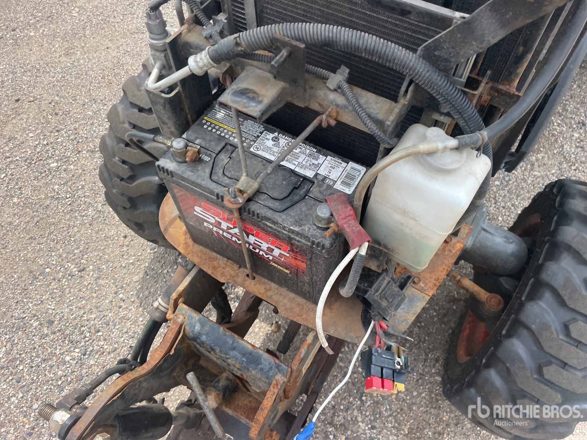

Got this new thing I gotta fix and have a 3 wires that were cut by the battery. Anyone now where they are supposed to go?

Those look like they go to the battery +. Is that one large and two medium gauge wires. Usually the large is from the starter, and the two med are to fuse/alternator. Nothing else is connected to the pos terminal right?

They were just cut when I got the machine. Right now the only thing connected to the positive of the battery is the larger heavy gauge wire and a smaller one with a connector.
I'll have to check the 3 wire gauges and colors tomorrow when I get to work.
If anyone has a pic of their stock one that would be awesome to see what it originally looked like!

fairly certain that set of wires feeds a set of slow blow fuses. I think those fuses are normally attached to a fuse block that slides onto a bracket just above those wires. I could be wrong.

I checked the wires and:
1 wire goes into fuse box and has 12v
1 wire goes to starter relay (12v supply)
1 wire goes to alternator post
I'm guessing they were all fused and connected together?

I've been diagnosing this thing and it appears to be 4 slow burn fuses at the end of those wires that were cut off. 1 wire comes from batter, one goes to alternator, and 1 goes to glow plug relay.
So far water was in everything, drained it all out, wouldn't crank off key and had to check continuity across all ECU pins and found sensors that were pissed causing the no crank. chassis ECU was OK. Then the main relay that energizes the engine ECU was not powering up properly and it appears I have a faulty engine ECU...on the hunt for one now since they seem to be unobtanium.
