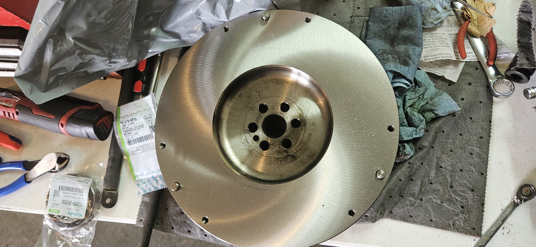

Flywheel is back, minus .0065 of thickness. The shop said it was in good shape.

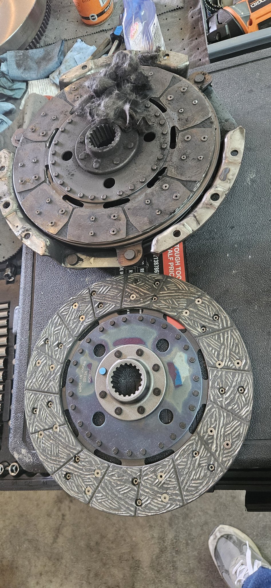

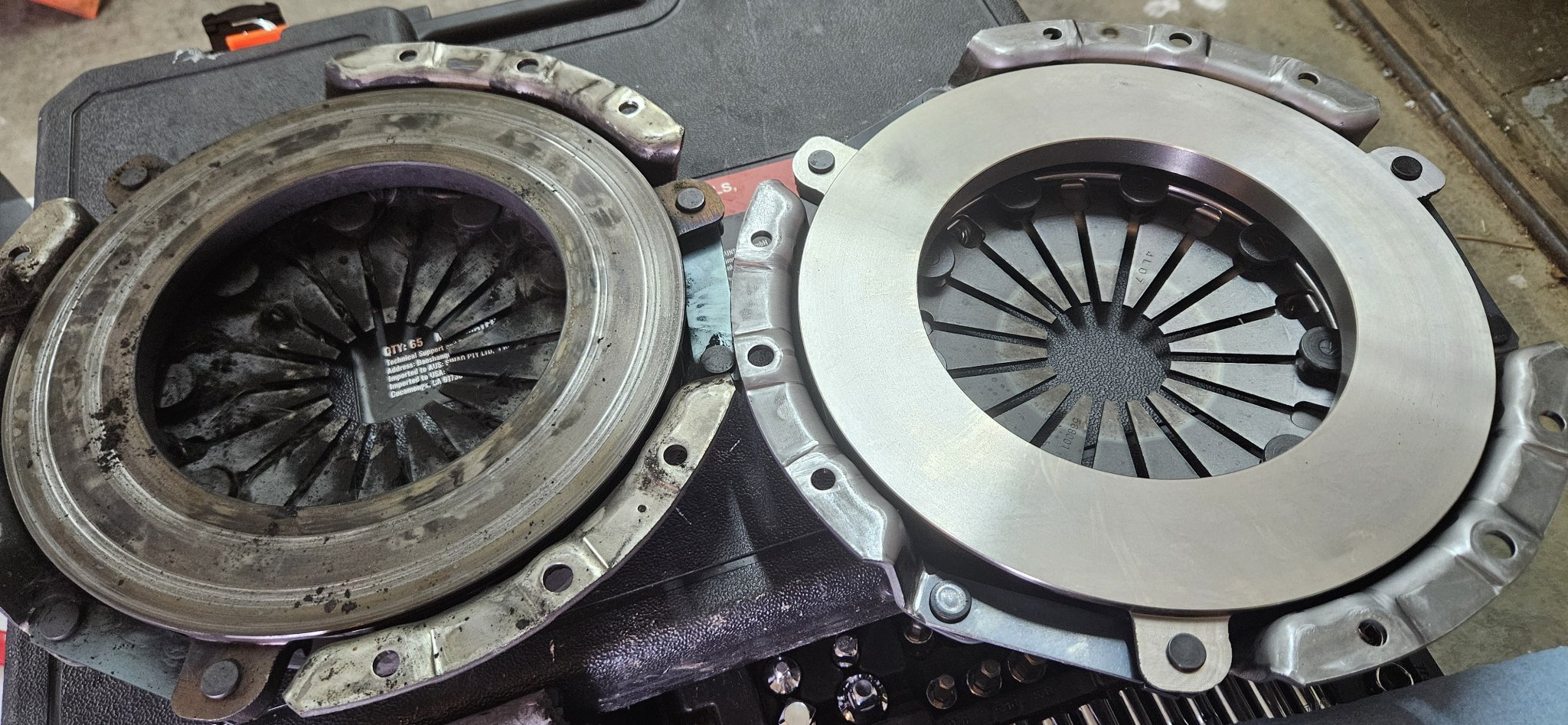

Messick's delivered super fast. Ordered yesterday at 1:35pm. Arrived at noon today. New and old pressure plate and clutch disk shown side by side.
