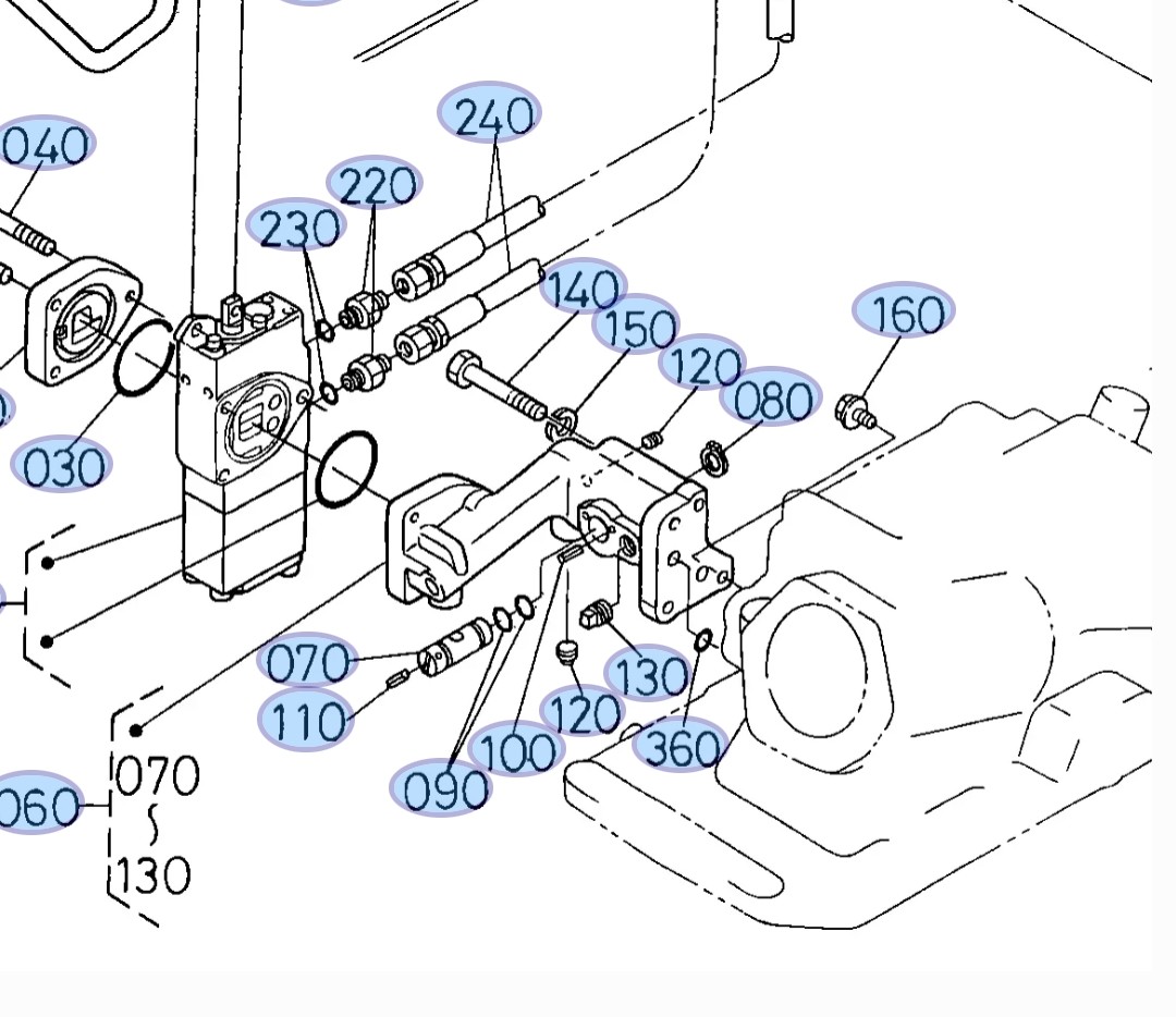

these are not really good pics but maybe they will make some sense of it? (The lower loop in the pic is what separates and connects to the BH.)
View attachment 155608 View attachment 155609
I believe those two hoses are connected to the aux control valve manifold shown below. They attach were plugs 120 abd 130 are imstalled.
If the tractor does not have remotes the BH would attach wiyh an adapter plate for the outlet on the side of the hydraulic cylinder case.
