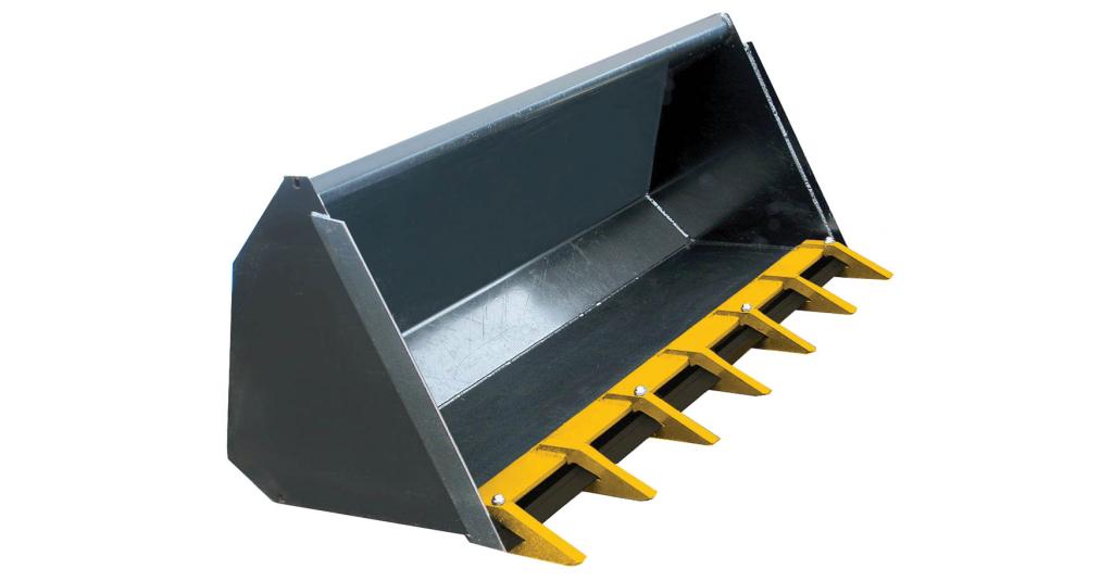

Piranha Toothbar and a box blade.
What do you use the piranha for and/or what are advantage does it give you? We live on sandy soil so breaking ground isn't a problem, although I've done very little digging.
I have a PTB, but it isn't on the bucket right now. It is really great at cutting brush off when clearing an area. I'm not sure how much it helps in digging, but I haven't used it a lot for that. I do a lot of road maintenance and take it off for doing that.
7,287
2,240
Mainly digging, (very hard-packed here) check this thread, posts 75-78. Actually read the whole thread, lots of info. It also cuts roots when digging that would have stopped the tractor with just the bucket edge. And recently, I found it works well on small to medium old pine stumps. Dig the toothbar in at or below ground level & curl the bucket; pops 'em right out.

https://northstarattachments.com/attachments/bucket-tooth-bar/
I bought this instead of the Piranha, the only thing I changed was buying stainless acorn nuts from McMaster Carr.
No drilling the side of the bucket, I ordered it through the implement dealer near me , total with shipping $425.
Very happy with this, it stays on tight and easy to remove, even with about a 3/4" droop in the center of my bucket.
Some have said the Piranha is not tempered steel , this one is tempered.
Basically the same price, they had very good information and answered any questions I had even through texts.
The biggest thing I liked not drilling through the bucket. tooth-bars@2x.jpg
