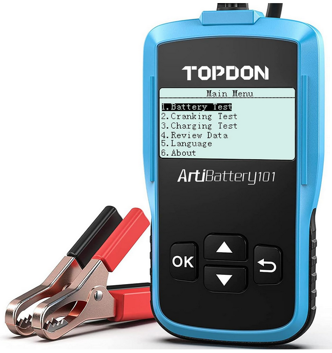

I bought a TOPDON battery tester off Amazon a few years ago and it's been pretty handy for me.
I've seen that brand so it's good to know that it works. There are two problems with taking the battery somewhere for a test. It's not convenient...and they make mistakes. So, while I think investing in a costly tester, it may be wise to have something. At least it would be a start when the tractor isn't cooperating to start.
