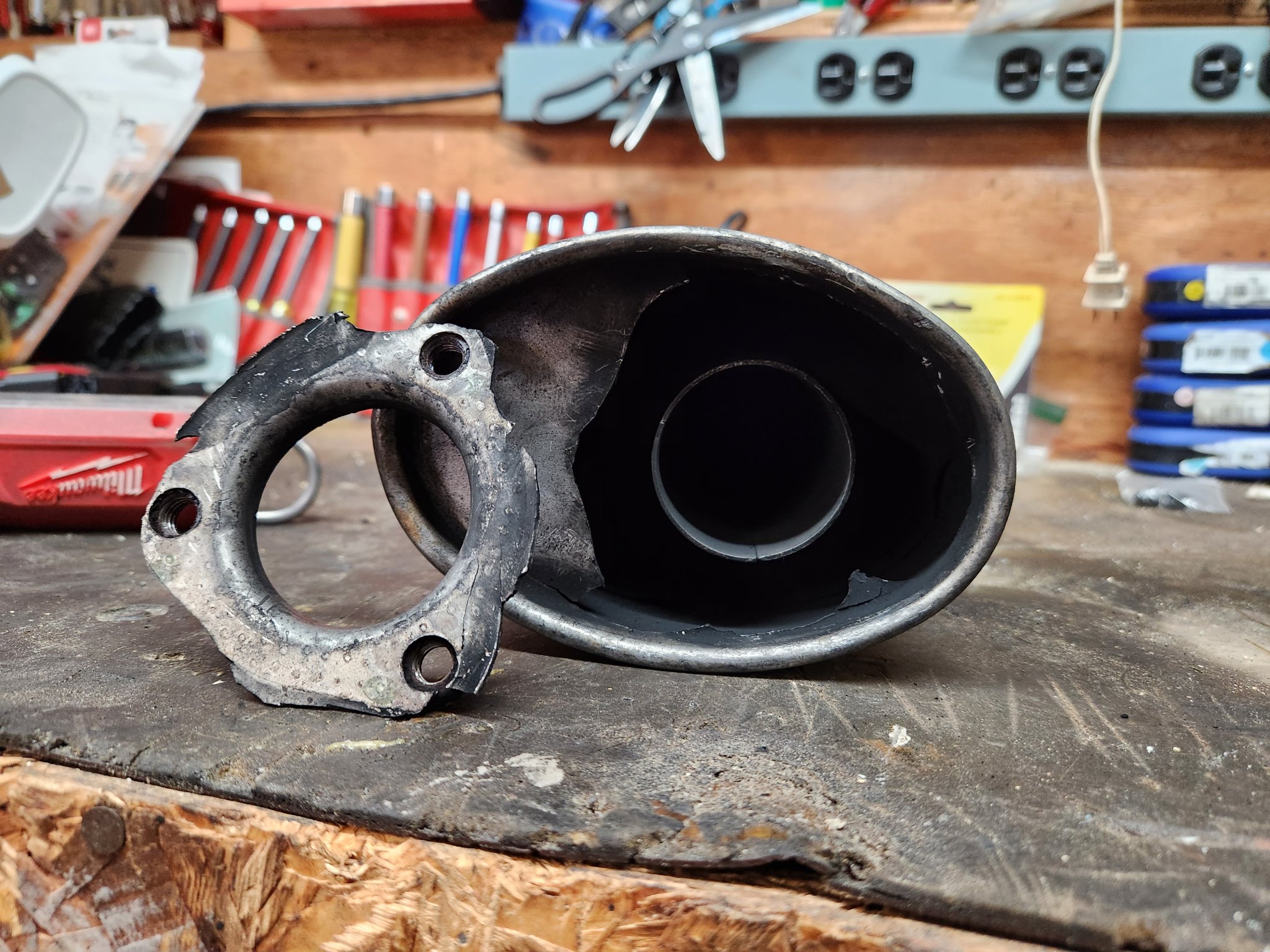

Going to pull it apart today and see if I can weld it up and also put some brace at the other end to secure it and keep it from vibrating. New Kubota muffler is $264! That's crazy!

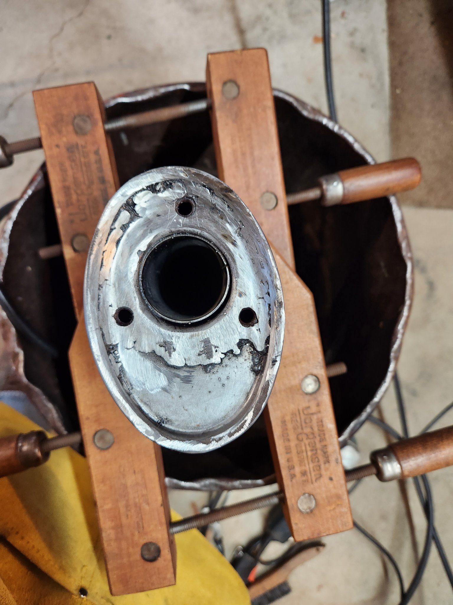

Took muffler off and welded it up. Not pretty but it saved $264 for now!

Looks like what is laying on the table with the end removed is oval and what you have welded up is in a round piece. Do you have a new muffler you are adapting?
Nope, same muffler. Just took the piece on the left and welded it back onto the piece on the right.
