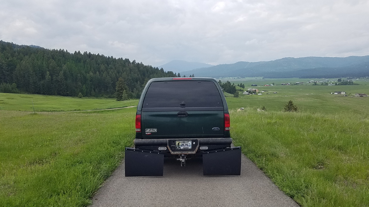

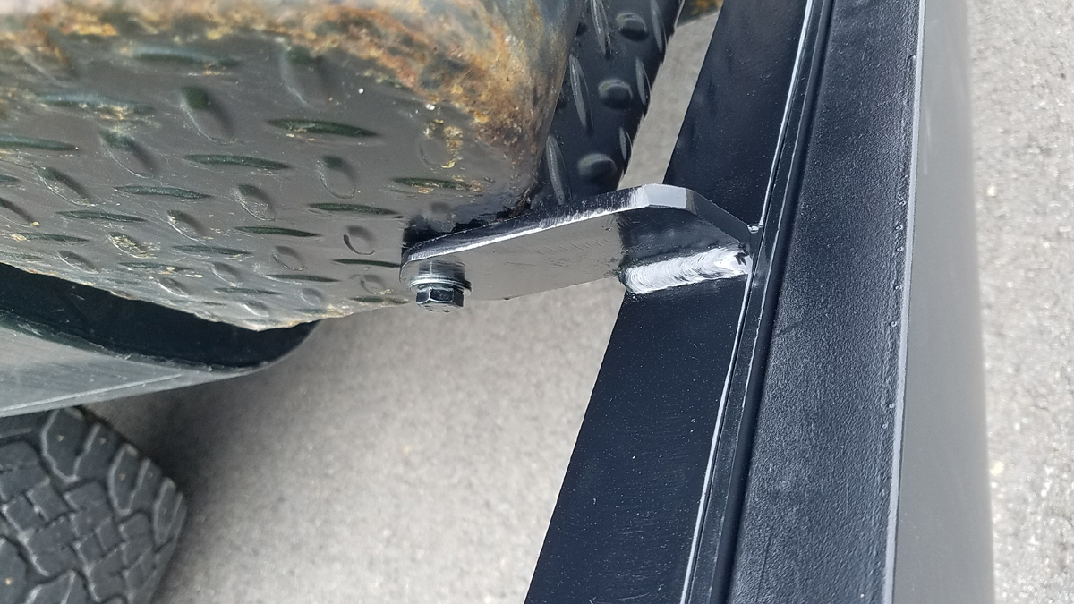

A bit of an update on this project. I got the homemade Rock Tamers installed this morning. I ended up adding some tabs in order to bolt the angle to the outside of the bumper to provide better support for the angle that the flaps are bolted to. The only issue now is that the flaps are a bit close to the ground and have a tendency to rub when making tight turns, or on uneven ground. I think I'll trim off at least an inch from the bottom, and maybe two. Overall I'm pleased with how they turned out, and all for around $27.
