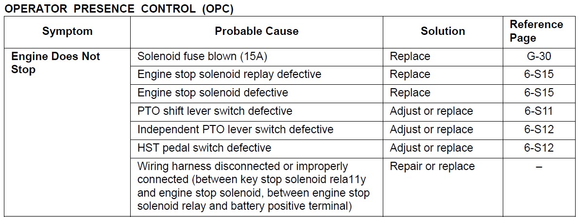

mower deck wont shut off if you are off seat. How do i troubleshoot?
The mower deck shouldn't shut off - the tractor (engine) should shut off.
The tractor has an Operator Presents Control (OPC). The safety switch in the seat is part of that system. If the PTO is engaged or you're pushing on the pedal to go forward or backwards and get up off the seat in engine should stop. Check the seat switch first.
I didn't see a BX1850 WSM on K-books but there is a WSM for the BX1860 which is the next model starting in 2009. The electrical diagram should be similar enough to trouble shoot.
