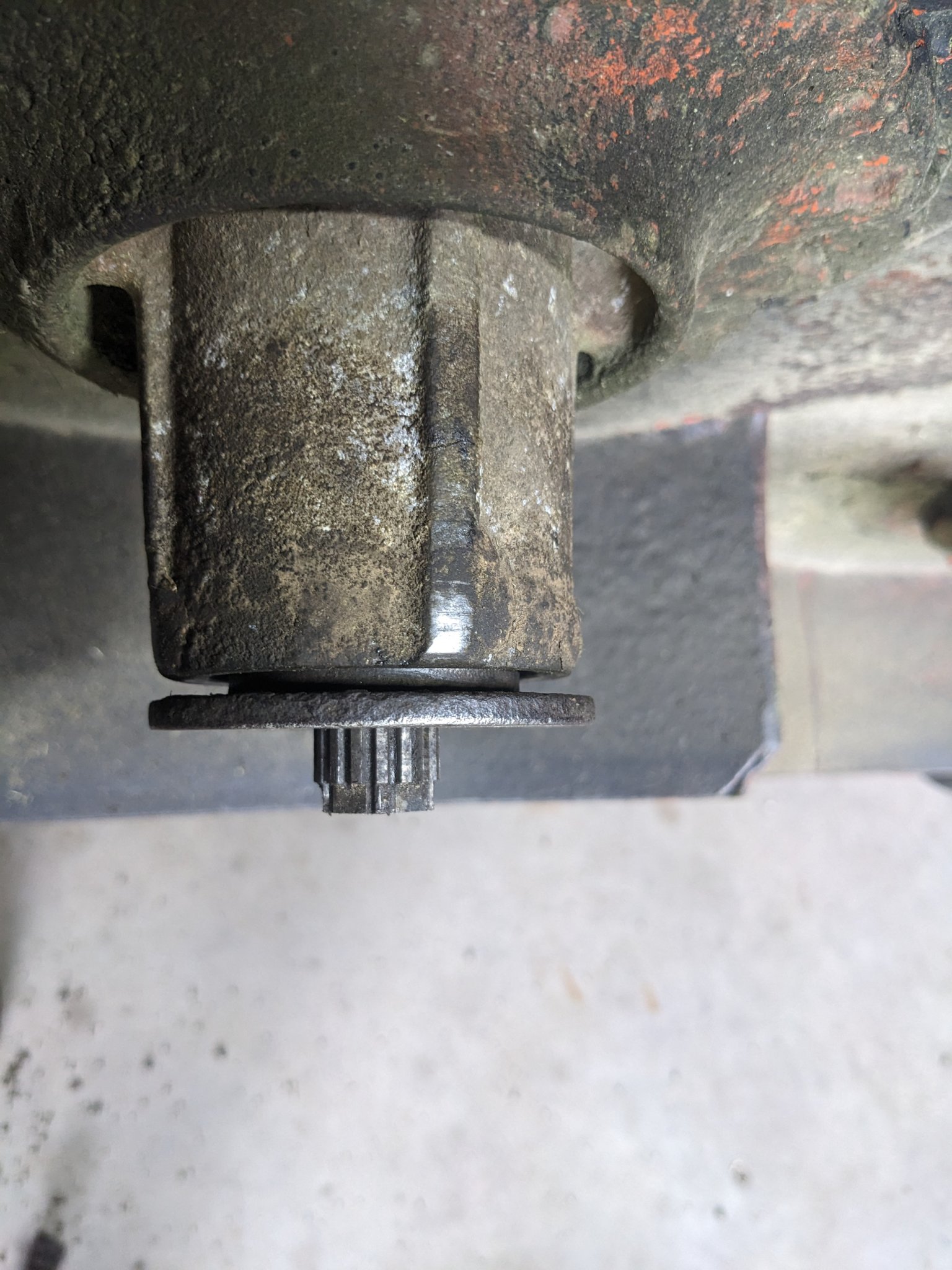

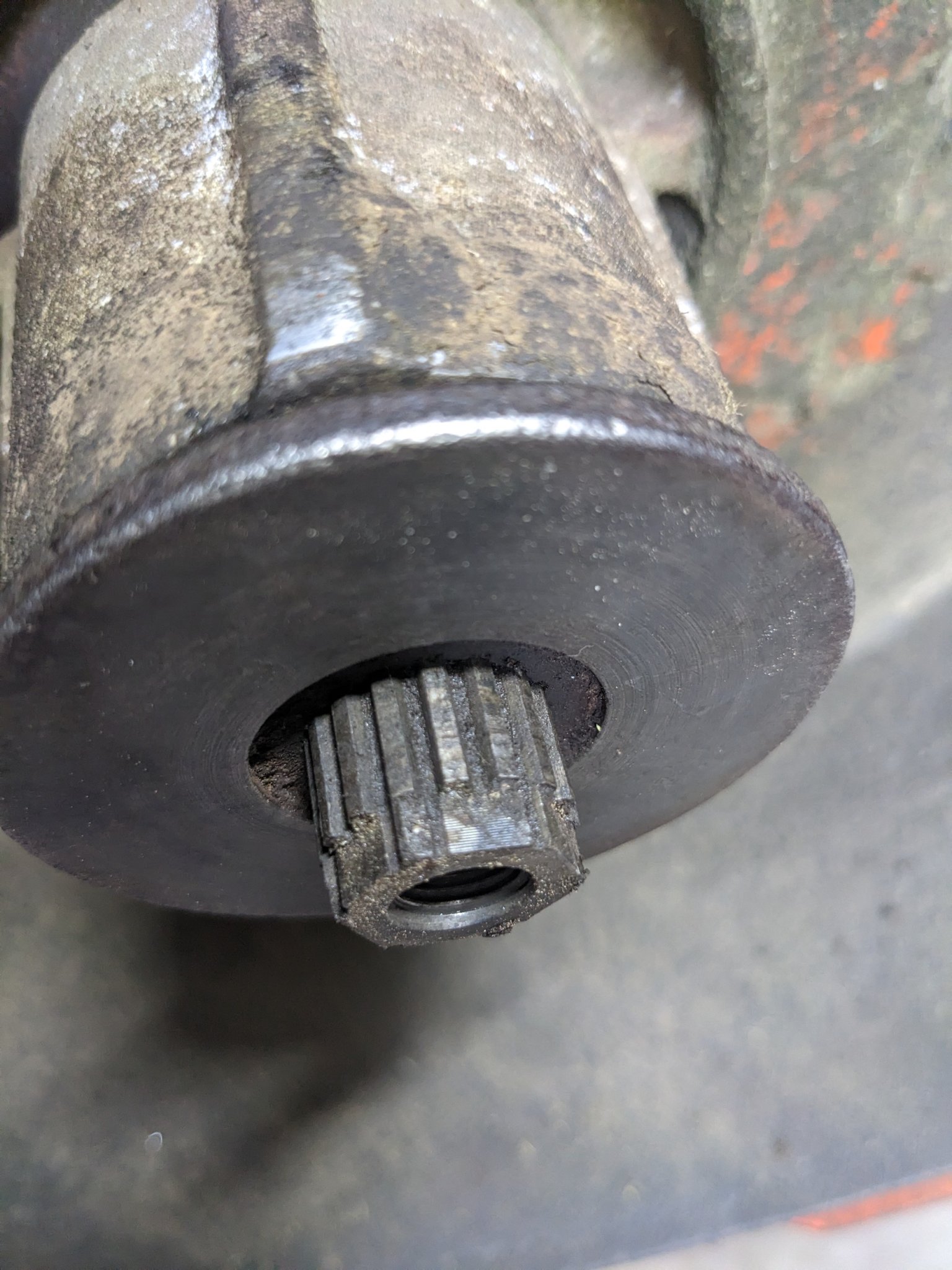

So I think I found my problem. When looking at the blade hubs I noticed the center hub doesn't appear to be fully seated in the spindle. I removed it and cleaned the surfaces but it still won't sit down. I can't even get the snap ring back in, the hub won't slide far enough to expose the groove. Any suggestions on where to go from here? A little persuasion with a hammer made no difference...
Edit - well that wasn't the issue. I got the center spindle put back together and torqued per the procedure in the service manual. Blade's still hitting. I'm going to take the right side spindle apart next to check bearings and look for anything bent.

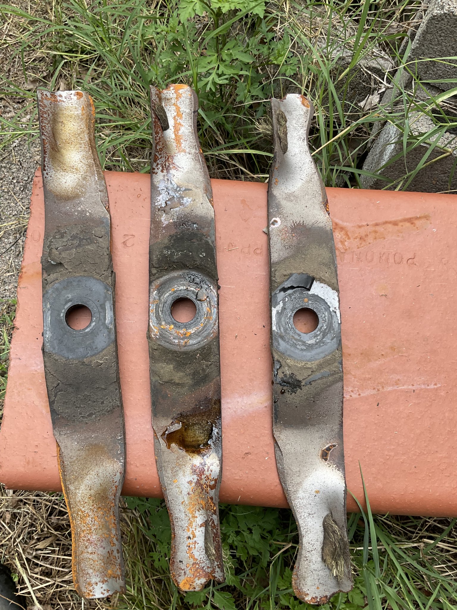

I have mowed 9 times this season for a total of 35 hours. Here is a picture of the OEM Kubota blades. They were shot, so I installed Oregon Gator G6 blades. I had the same blade hitting problem, so I ground the outermost blade a little bit. Hopefully these Gator blades will last he rest of the season and then I’ll try to straighten the deck. It still doesn’t make sense to me that only 1 side of the blade hits. I guess I’ll never understand that.

Is the picture good or is it distorted? Those blades look like they came from a dumpster (and were sharpened by an angry beaver). The picture would indicate they can't possibly be balanced. Looks like there's a difference of about 1/4" or so in the width when comparing both ends.

The picture is not distorted. The soil here is really sandy (obviously). In the picture with the three blades, they are in reverse order. The left blade is the outside blade, next is middle blade and the right blade is the innermost blade. I don’t know why the outside blade isn’t as worn/sandblasted as the other two.

Having the blades match each other would be nice, but not nearly as important as having each blade match ITSELF on both sides of its own center is a big deal.
View attachment 131719 View attachment 131720
Sorry for the late reply, I forgot about this thread. I ended up replacing the blades, dust cups, spring washers and hex washers on all three blades. The spindles were all removed, cleaned and reinstalled. I also loosened all the bolts on the gearbox mounts and retorqued in order according to the manual.
The deck is back on and cutting fine now. I'm not sure exactly what the problem was but it seems to be fixed. I'm going to try removing the front baffles next to see if that helps the cut quality at all.
