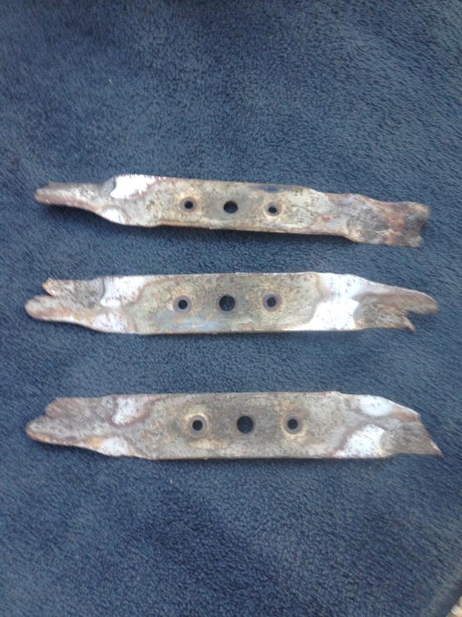

Here's a pic of what happens when a dumbass punk kid (not my son) uses your mower. I believe he couldn't decide if he was mowing grass, crushing rock or cutting trees. Needs less to say that was the last ride on anything I own.

If its like those pictures, cutting grass or blowing grass near or off the gravel will wear them quick. Slowing mower a touch may make all the difference. Blade tip speed above supersonic is bad on a couple levels. Throw some sand in there and its the nature of the beast. Given enough time i can sandblast a hole through a piece of steel
That kid must have taken lessons from mine :rolleyes: After the second time he chewed them up, I had him pulling the deck and fixing his mistake and working off the new blades. Plus a little extra for the pita factor ;)
If it had been my son we would have had a chat about what was done wrong and what could be learned from the mistake and then I'd supervise him doing the repair. This however was a kid in the neighborhood that we were trying to help out and maybe give him some guidance but in the end he was a lost cause.
