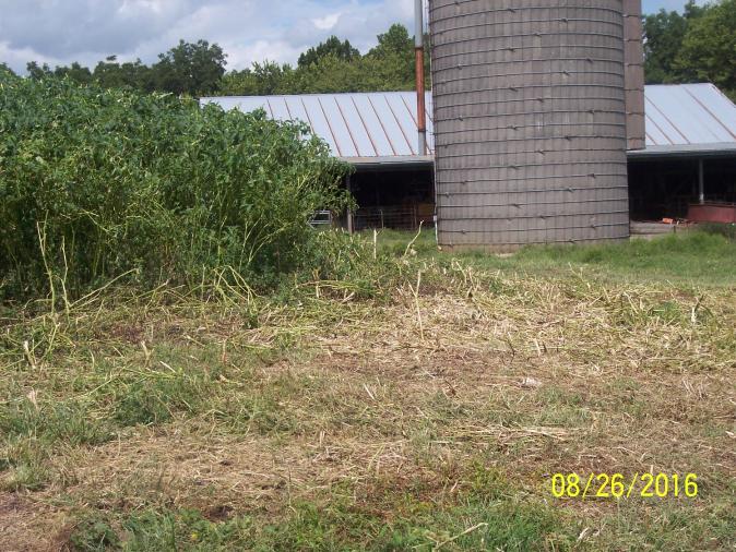

I have a Ford 6' flail mower that I bought from a guy that mowed about 15 acres with it and never did much for maintenance. It shows it. I replaced a couple of bearing on the rear roller, and welded up some brackets, that's all. Did nothing to the knives.
I pull it behind a Deutz 6206 which is about a 60HP tractor. I've mowed "stuff" that was 5' tall, just to see what it would do. If I set to mower down like I was mowing a yard, it mows as nice as a finish mower. Unbelievable really!
