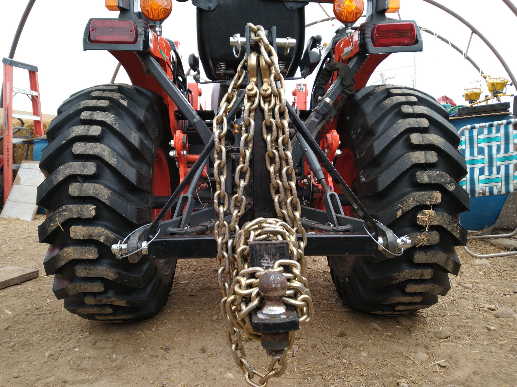

I have the attachment that screws on the bucket lip. It works good, but its hard to see the ball to hook up to the trailer. I also have one that goes on my quick attach on the 3 pt hitch. I like that one better, because I can see it easily, but a lot of times the 3PH is occupied and I need something for the front.

Pic 1 ball at tip of fork, very useful for when the chipper's in action, shifting the trailer from branch pile to pile.
And for the long haul later out of the bush hauling chips, firewood, the 3-point receiver frame. The forks are limited for any distance hauling with a trailer loaded, but for short maneuvers and unloaded trailers they're great. But bringing home the wood needs the 3-point a-frame. That a-frame is also really good for skidding logs with a chain!
