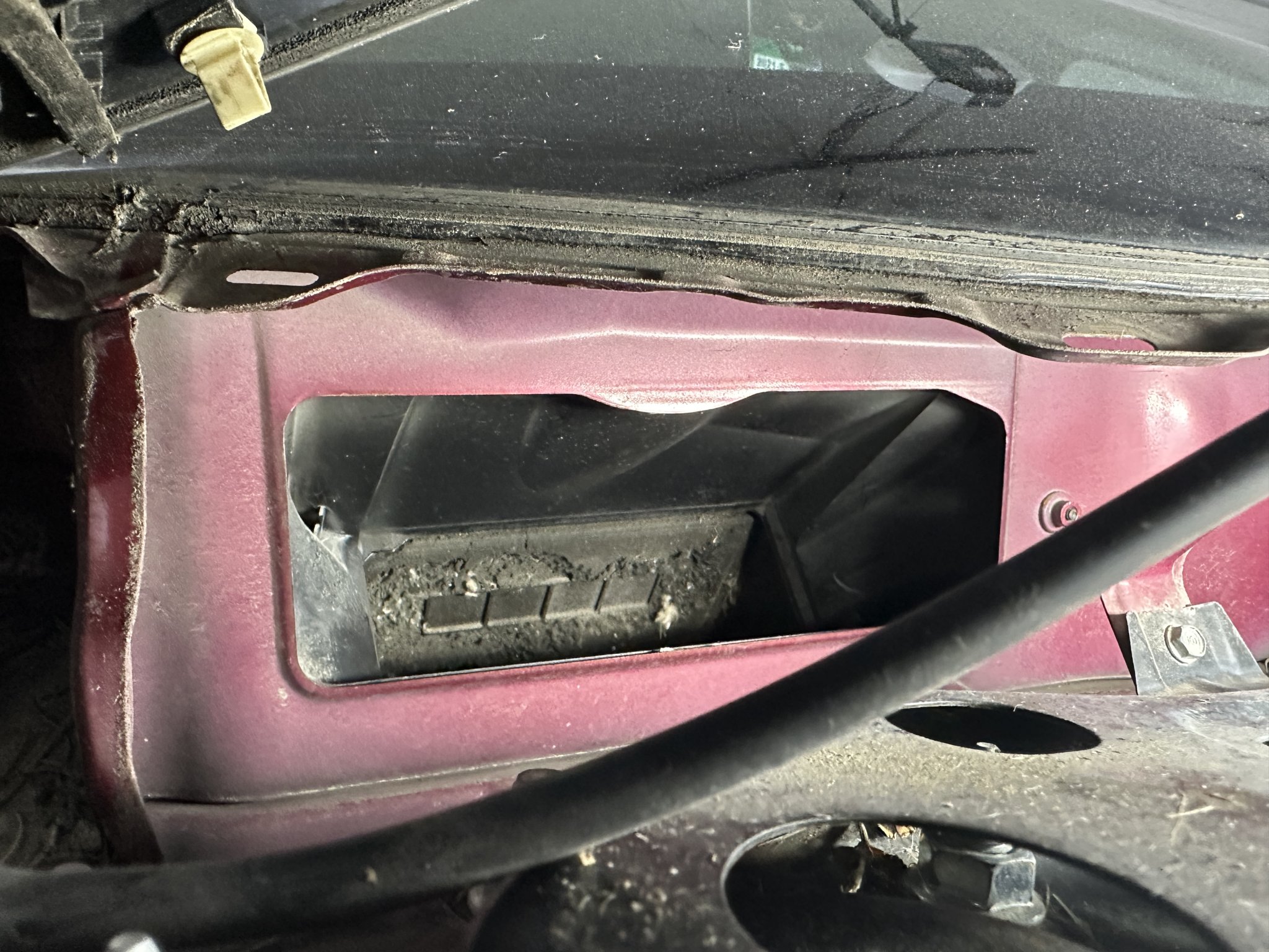

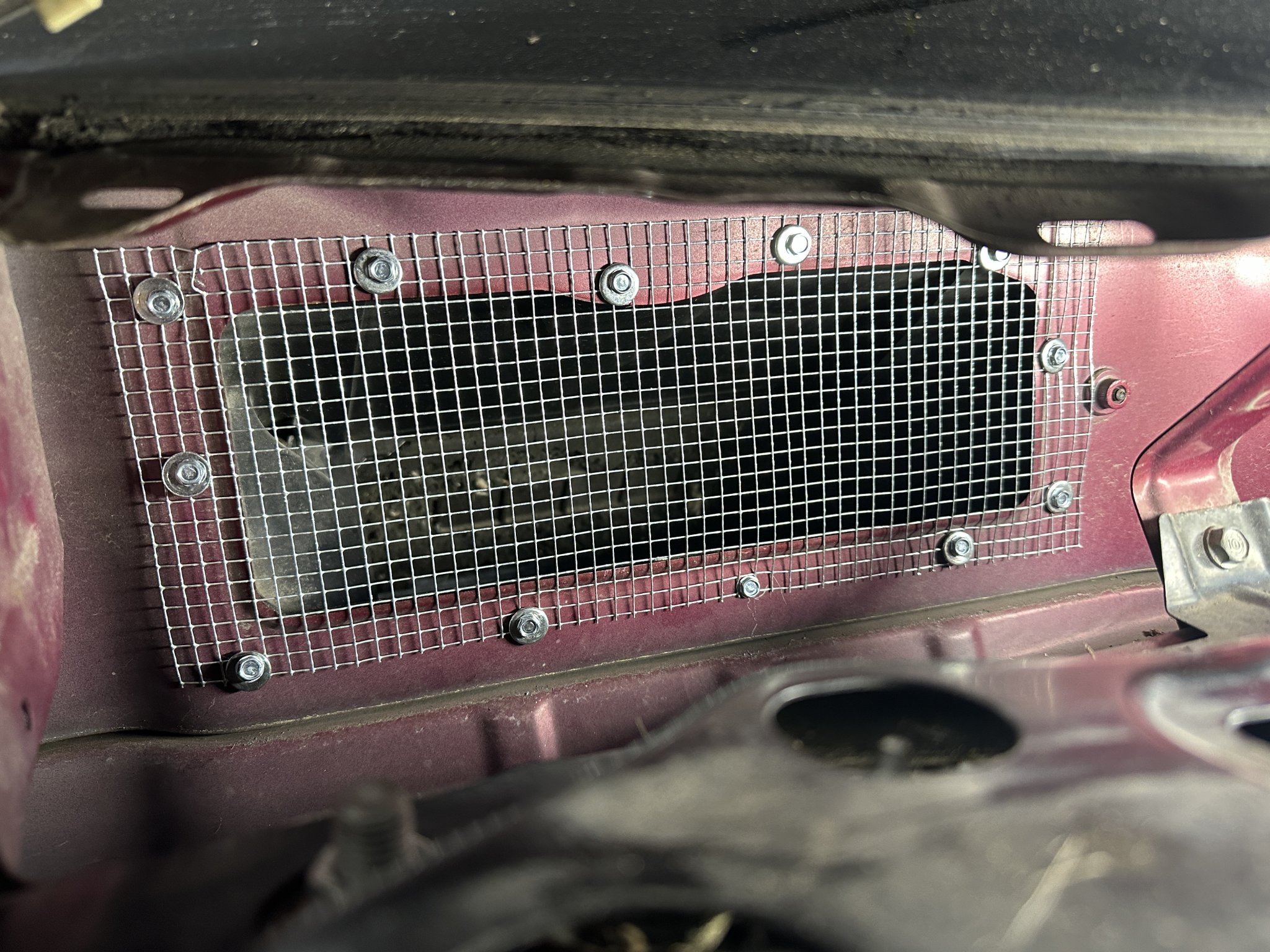

Never had issues with mice living on the cabin air filter until the last two years with this year being the worse. They don’t make it past the filter but make a stinky mess. Well today was evection day. 2x5 piece of .25 wire mesh and victory is mine. Well, until they find a new way in

Nice job on the screen!

Nice job on the screen barrier, I would also add a one or two dryer sheets, they hate the smell and won't chew on it to make nests.

My neighbor has cats. Lots of them. We have a few that make their rounds through our property but they avoid our buildings. I think he has them just to feed the owl and hawks around here. I’m highly allergic to cats so we will not have them. The actual screen size was 12”x5”. I’d do the dryer sheet but it is our old CRV that the boy drives. If he wants it to smell nice and deter mice, he can do it. I may get in to our Accord and Ridgeline this weekend. I bet Honda did not add a screen to those either. Super easy access. Remove the wiper arms and pull 4 push pins then pop that plastic cover off. A few self tappers and job done.
I did a bunch of traps when I noticed mouse droppings in December during the cold snap. We got 4 and since that point I’ve not seen signs in the equipment or on the floor. Helps that we haven’t had a winter and they are staying outside.
