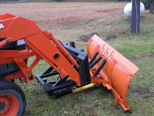

this is how i did mine.
Pretty similar to what I'm planning on doing soon. I'm gathering needed bits and reading up on ideas and tips from others.
I have an old Western 8' Pro Plow (sold my old truck, but kept the plow) and picked up a 3/8" quick attach plate. I removed the light frame and pump and will cut/modify the A frame as needed to weld to the mount plate. I can't decide if I should buy/make hard lines to run forward for angle function, or just really long hoses to rear remotes.
