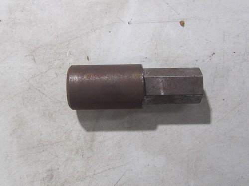

Here is a repair pin:

Hi Wolfman,
Thanks for the input.
This may be one of the very early models. the drawing shows a shaft with a nut on the end.
so i'm wondering if some heat and holding the other end fast may break it loose.
