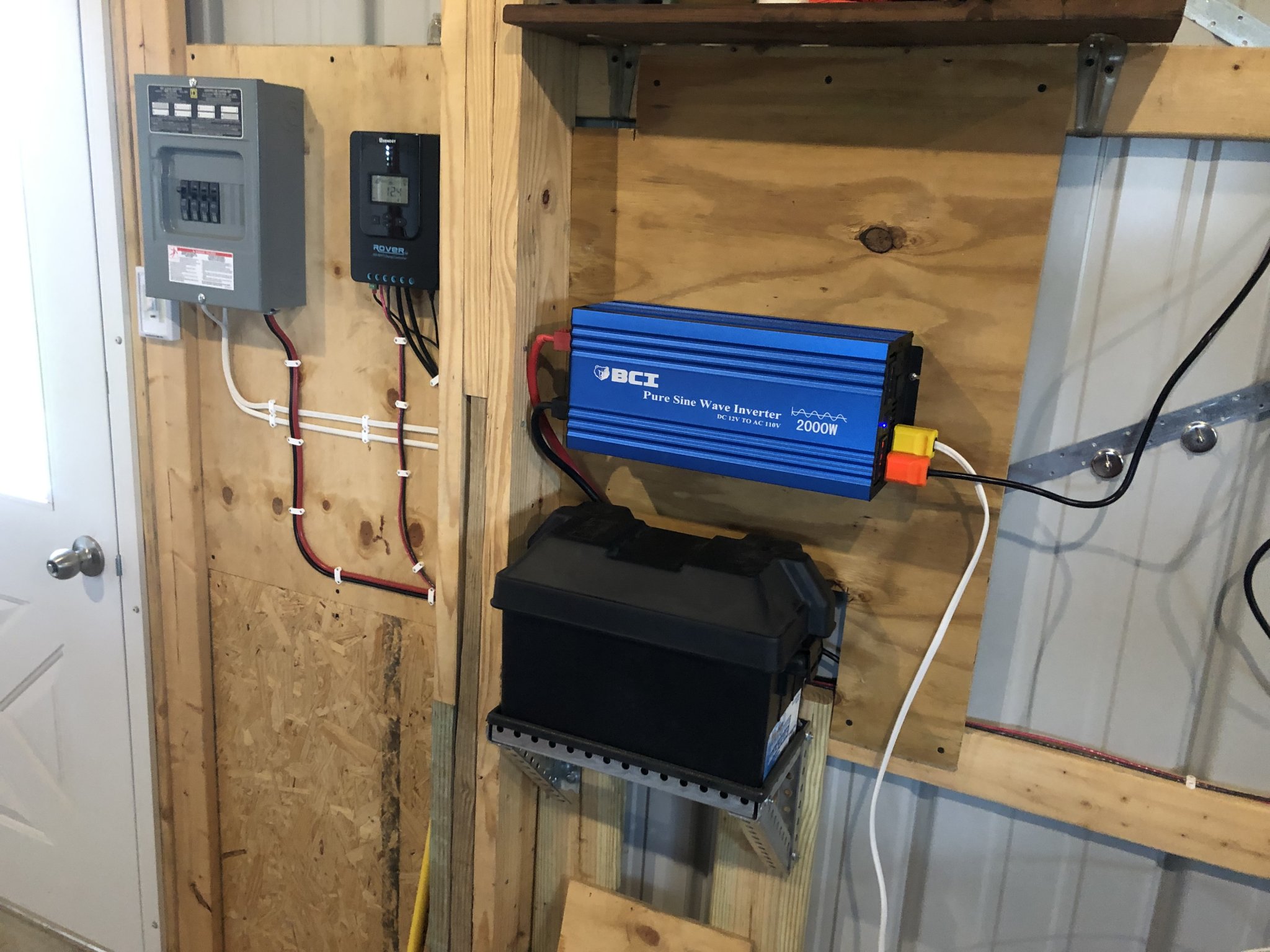

Yes. I don’t do much work in there. I just need enough power to run the lights, a fan on the porch, and to occasionally run my pancake compressor to air up tires. I’ve also used it to run a battery charger. When I was building the patio, I used a 7 Amp angle grinder to cut the curve on the blocks. It ran for about 1-1/2 to 2 hrs before the battery (deep cycle marine) ran down enough to shut the inverter down due to low voltage. Additional batteries would have obviously extended the run time.
This was my first time messing with solar power so I did a lot of research before I bought anything.

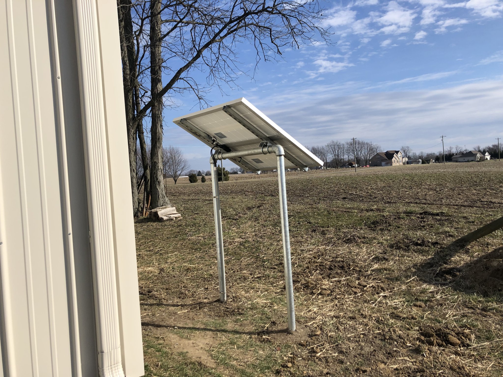

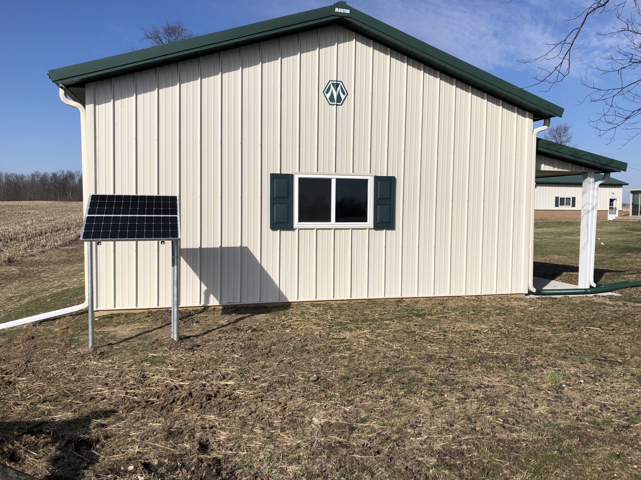

Feel free to ask questions and I’ll try to answer them. I don’t claim to be even close to an expert when it comes to solar power. I knew basically nothing about it before this project. I just did a lot of research online and talked with a coworker who knows about solar.
My setup is:
Renogy 200W premium package with mono crystalline panels, 20 amp Rover charge controller and bluetooth module
Square D breaker box with QO series breakers
They are rated for up to 48V DC whereas other breakers only work with AC voltage. Way cheaper than special “solar breakers”
Duracell Group 27 deep cycle marine battery
BCI 2000W running/ 4000W peak pure sine wave inverter. Pure sine is more expensive but it is cleaner power than modified sine wave.
The lights are 6 x 60W equivalent A base 12V LED RV bulbs in porcelain bases that are wired to the breaker box with 14-2 Romex. If some day I run power from the house, all I have to do is change out to 120V bulbs.
The panel mount was built to allow easy adjustment of panel angle between summer and winter.

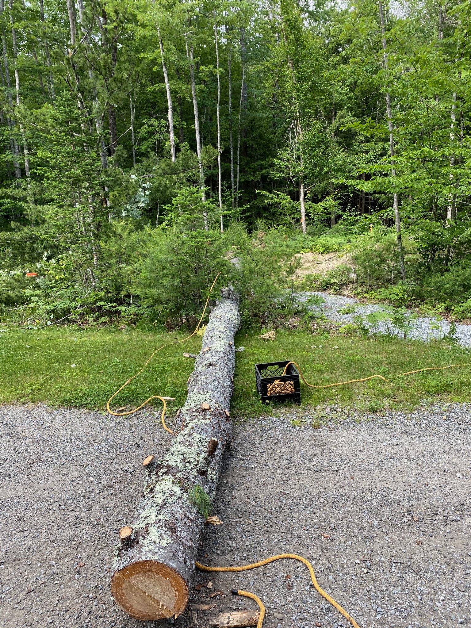

"Tree Guy" started with the biggest tree yesterday. Was a bit of a beast to ge the logs out and loaded. We ended up using my snatch block with his long line and truck to "yard" the logs to where they could be grabbed and loaded by the rig.
Too bad no one had a sawmill ready to take these logs as they were beautiful pine with tight grain. They were donated to the local volunteer fire dept as they chop and split pine to sell for the local campground to raise money for the dept.
When Matt climbed the large tree he got up top and shouted down to myself and his wife (his spotter) "this is a pretty funky tree"......as it leaned in 3 different directions over the course of the trunk.
More cleanup then dropping the smaller trees next week.

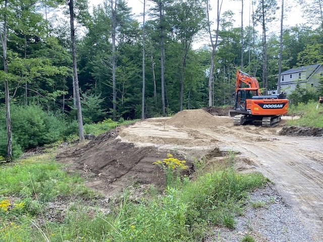

Site work has been going fairly well. Although I cringe every time another dump truck of clean fill comes in......lol $
Bringing things up to the driveway grade.
It will be nice to not see the neighbor's house at all once the building is up along with the solar and landscaping.......

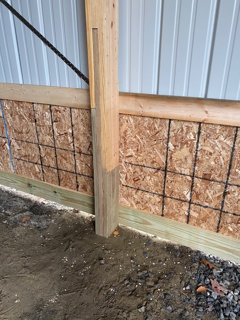

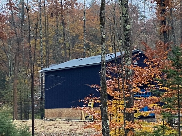

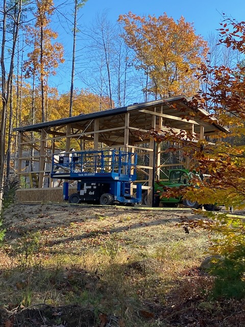

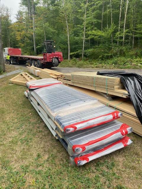

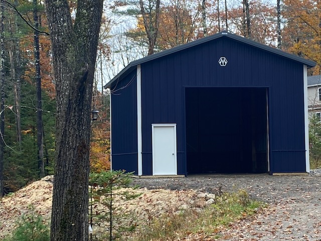

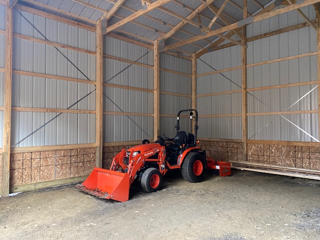

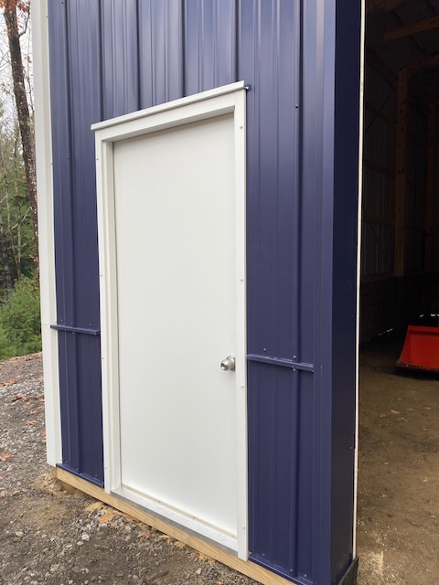

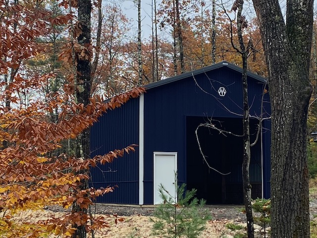

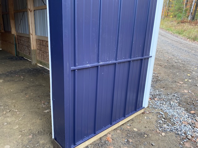

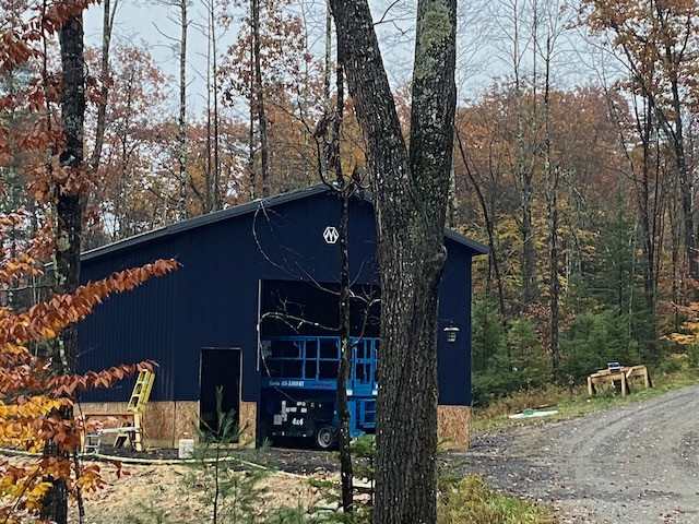

OK, time for an update. Building was delivered in September, and they just spent the past 4 business days assembling it. Everything is now done with the exception of the overhead door (next week) and pouring a cement floor in the Spring.
Very pleased with things, always want bigger but.......

Congratulations!
Morton buildings are excellent!
My 36' x 48' Morton is now 38 years old, and still looking great!
