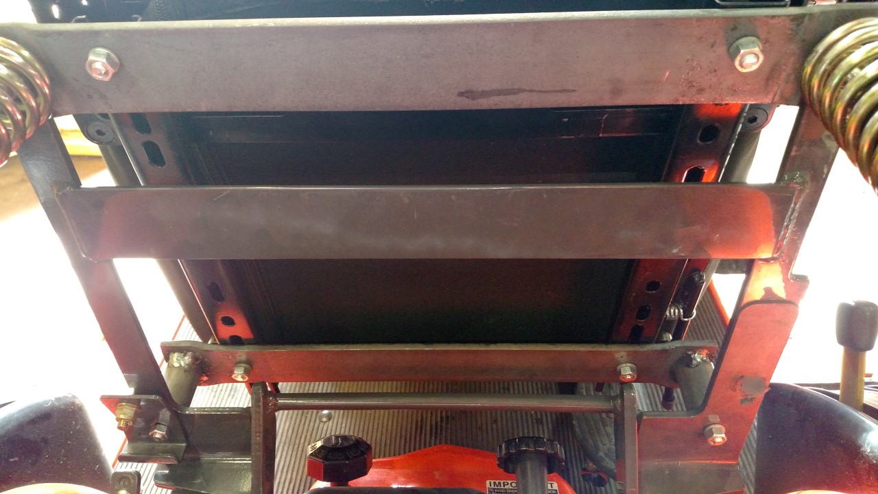

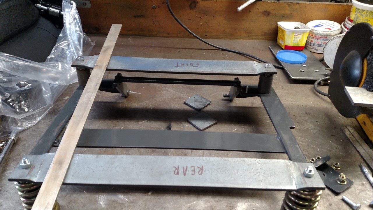

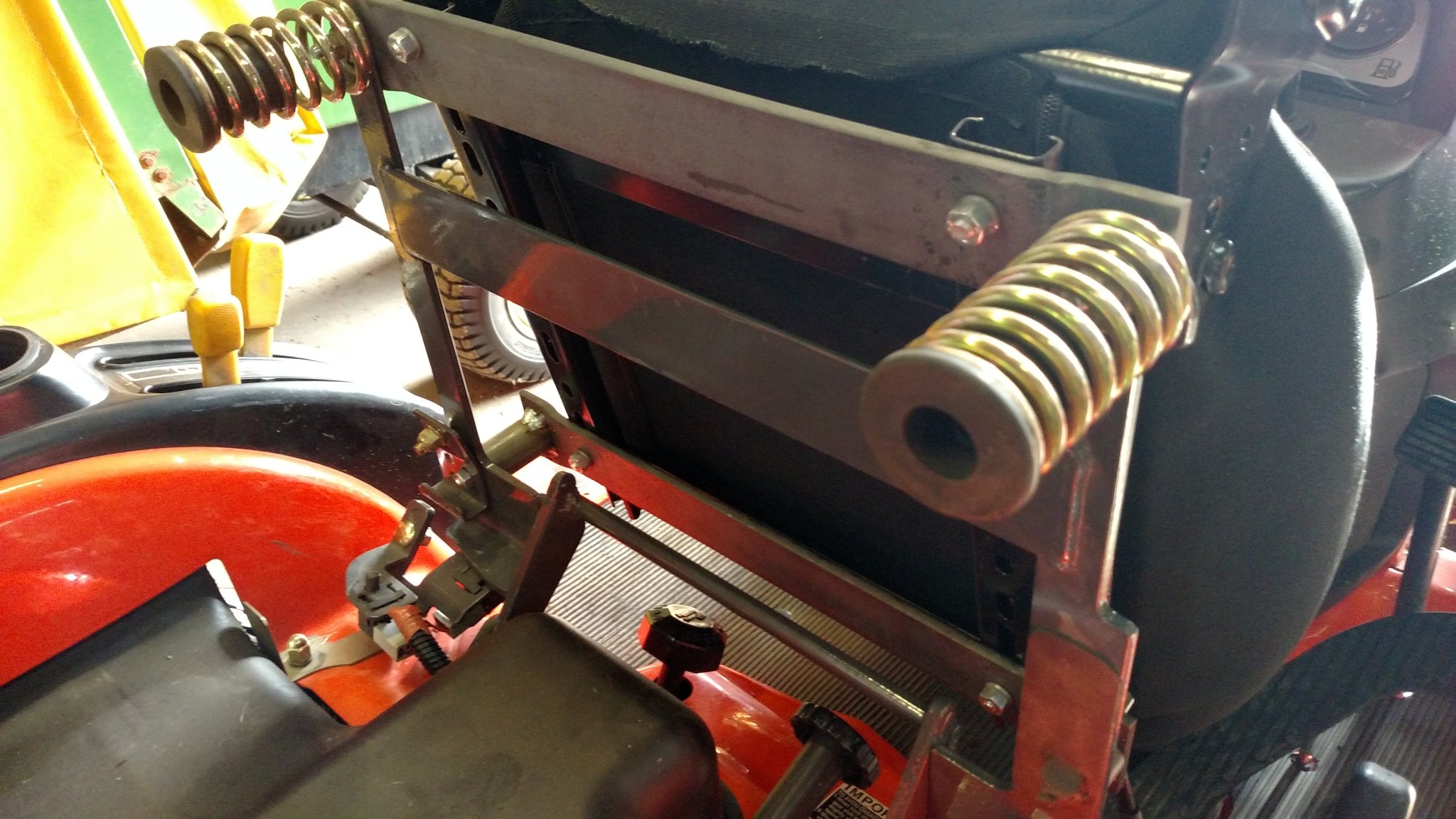

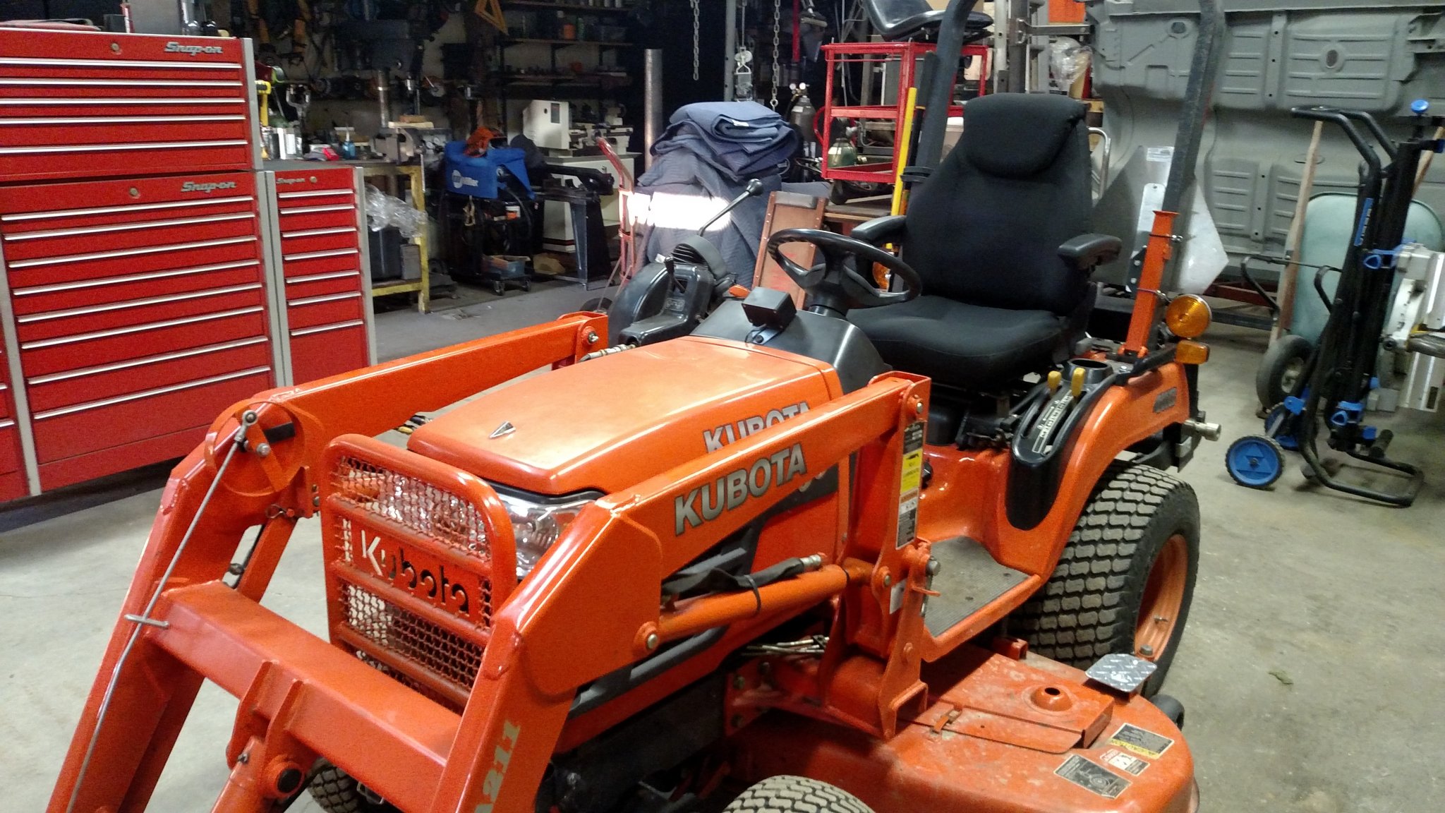

I replaced the seat on my BX with a much better and more comfortable seat I got on sale at Rural King. I had to fab an adapter out of some 2" X 1/4" strap and some bar stock, and I made the seat set level instead of tilted up in the back. Is way more comfortable than the original seat. It also has adjustable armrests that aren't shown in the picture.
One of the best mods I made to my BX.

That looks like an earlier BX. It's my understanding the earlier versions had really crappy seats compared to the **70 Series and up. If I had one of those, I'd probably make some sort of change as well.
Nice job, looks like a real nice seat too.

Thanks.
Yes, it's a BX2230. It's a really nice seat and it's like riding in my F150 now. I still want to take the adapter off and paint it or get it powder coated ROPS gray. It was a quick and dirty job one Saturday afternoon when the grass was getting really high and I didn't take the time to smooth up some edges and corners and paint it.

I think you guys are over thinking this,, I added a couple old valve springs
I tried your suggestion today and the difference it made is amazing. For me it was free because I had some old valve springs from my Model T on hand. Great suggestion, thanks!
