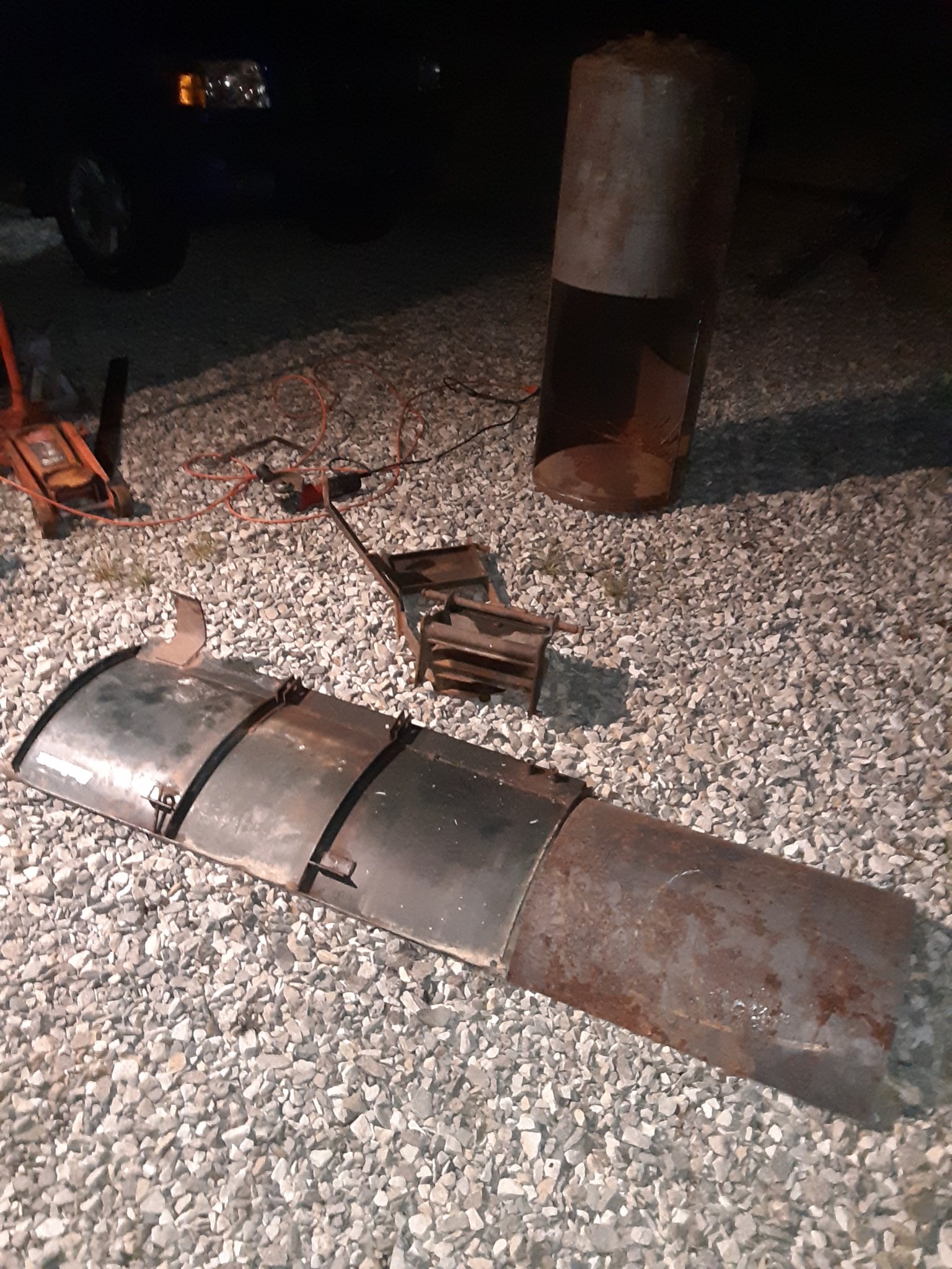

I wanted a front mount snow blade to attach on my loader, so I modified an old Bolens 42" blade that a friend gave me. Here it is near the start, along with the old water heater tank that I used to extend the plow.
I added around 11" to each side, and built new rear ribs from flat plate. Lower structure is simple 2" angle iron.
I modified the old Bolens framework too. I widened the attachment points, put in some spreaders, and a piece of pipe to drop a 1/2" pin through to hold the angle adjustment.

Edit: if those are the original trip springs you may need to either add additional ones or replace them with stiffer ones. I made a plow some years ago for a lawn tractor out of plate steel I recylced from a building. The biggest hurdle was the trip springs and getting the plow to not just flop over when it got loaded up
I did think about the springs. I found some that are similar sized and made for a 60" plow, but figured I'd try it first and see how they work. Easy enough to change them later.

Nice job . How much did ya have to change the water heater arc to match the blade ? If thats a real Bolens blade , like from 60-70's them springs are pretty hardy . Bolens built their tractors & implements to last back then . I have 3 that run & another waitin for the rite rainy month . DO ya have a link for the SSQA plate ?

The heater tank panel was close enough that I just bounced on it with my feet to bend it some, then used C-clamps to hold it for welding.

I did the same thing with a J Deere 44in. blade. Mine attaches with padeyes in the pin on bucket on my 2301. The inside of the water heater was very rough , the glass lining?, that I end up using the outer metal cover , the white side out, to help snow peel off the blade. It also added weight which helps. Altered the skids and trip springs .
