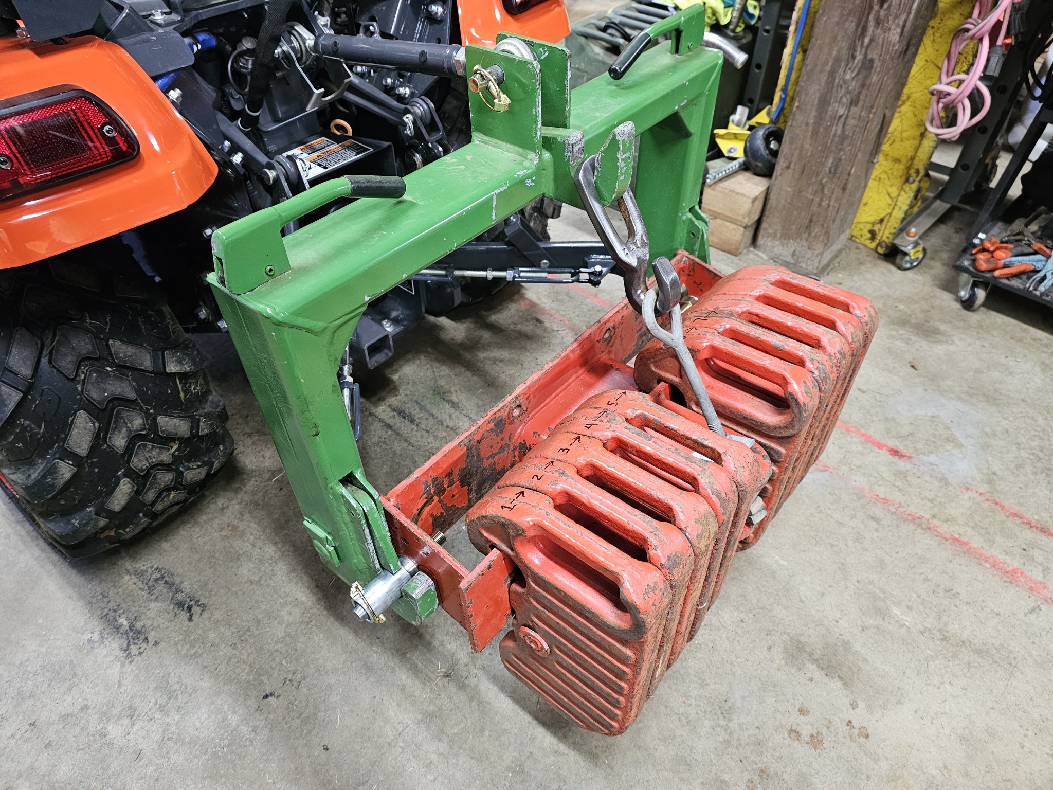

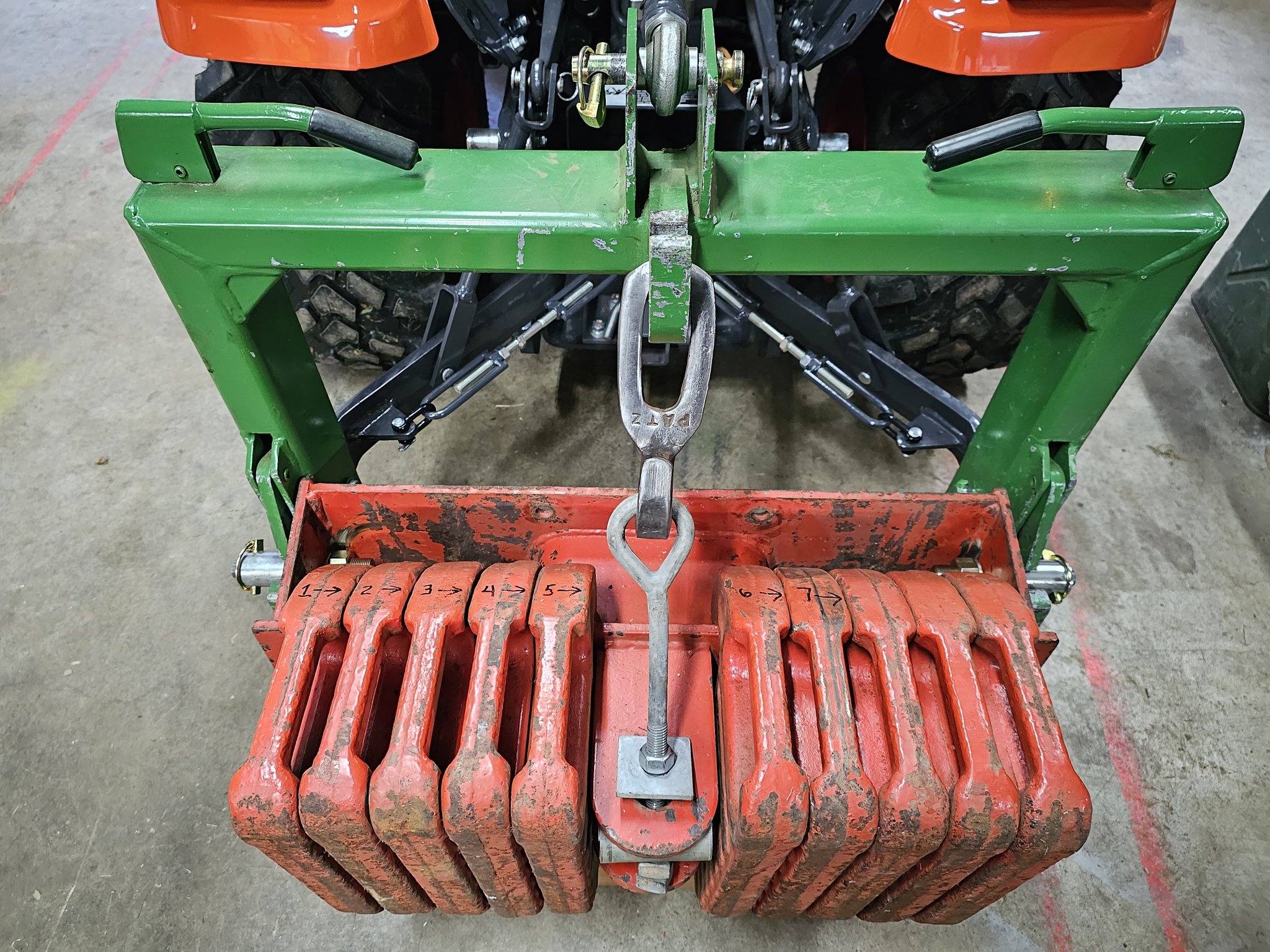

I've had this 550Lb weight pack on the floor of my shop for a couple years (Pre-BX23) now. Since buying my tractor, now I can use it. I've no idea where the (edited)>"Patz" hook came from. Almost like it was meant for how I used it.
Put together today. I definitely need a cart under it. I'll pick one up at HF later this week.

Dolly finished. 4" Castors.

"Pats" hook ???
That "hook" is called a..... "Pats hook"?
Never heard of it!
Looks handy though.

Typo is fixed. PATZ is stamped into it. Further looking, it's a Chain Hook from conveyor type systems.

I don't think that a Horror Fright dolly is going to hold up well to that weight. I suggest that you buy some 4 or 5-inch rubber or polycarbonate wheels with good quality bearings and make your own dolly out of some strong wood.

Haha, you are right about the HF dollies. I did the test, the weight bowed the Dolly BAD.
