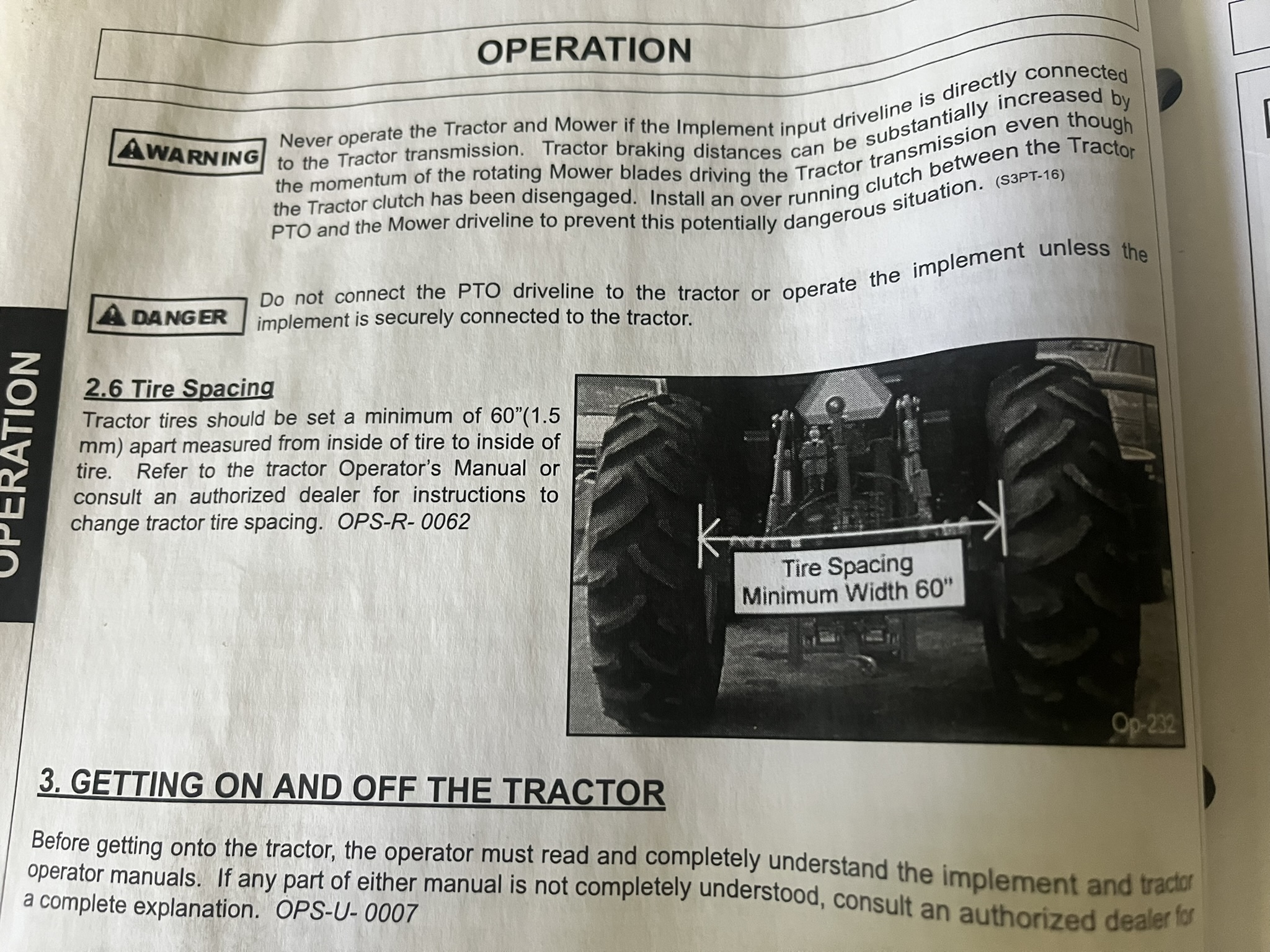

My bush hog (Bush Hog BH216) manual states that the tractor tires must be spaced at least 60", inside of tire to inside of tire. My tires (of my Kubota L4701) are currently spaced at 36" and I don't see how to make them wider (the rims are already set so the tires sit as wide as possible), let alone 24" wider. Besides, if I set the tires an wider, they would be wider than my mower which I don't want.
What do I do? Is it alright to just ignore that guidance? It seems like anyone with my tractor and a 6" mower (i.e. a lot of people) has the same problem.

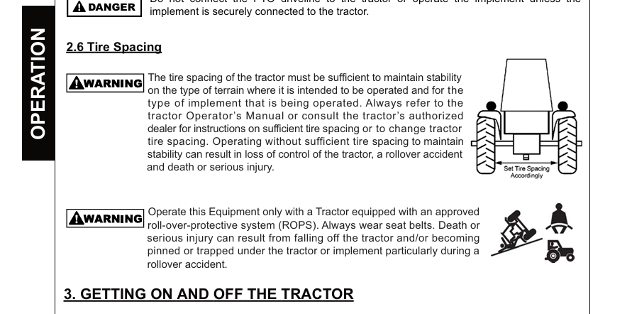

Can you take a screen shot of the manual with the 60" minimum tire spacing and share here? I do not doubt you but wondering what version manual has this information. The manual I pulled up seems to be the latest version that Bush Hog has available as a PDF on their website.
I pulled up Bush Hog's user manual for the BH200's series which covers BH216 and this is the only thing I can find concerning rear wheel width spacing.
Copy and pasted from the operators manual.
"The tire spacing of the tractor must be sufficient to maintain stability on the type of terrain where it is intended to be operated and for the type of implement that is being operated. Always refer to the tractor Operator’s Manual or consult the tractor’s authorized dealer for instructions on sufficient tire spacing or to change tractor tire spacing. Operating without sufficient tire spacing to maintain stability can result in loss of control of the tractor, a rollover accident and death or serious injury."
page102image257780048
This manual is published 12/21

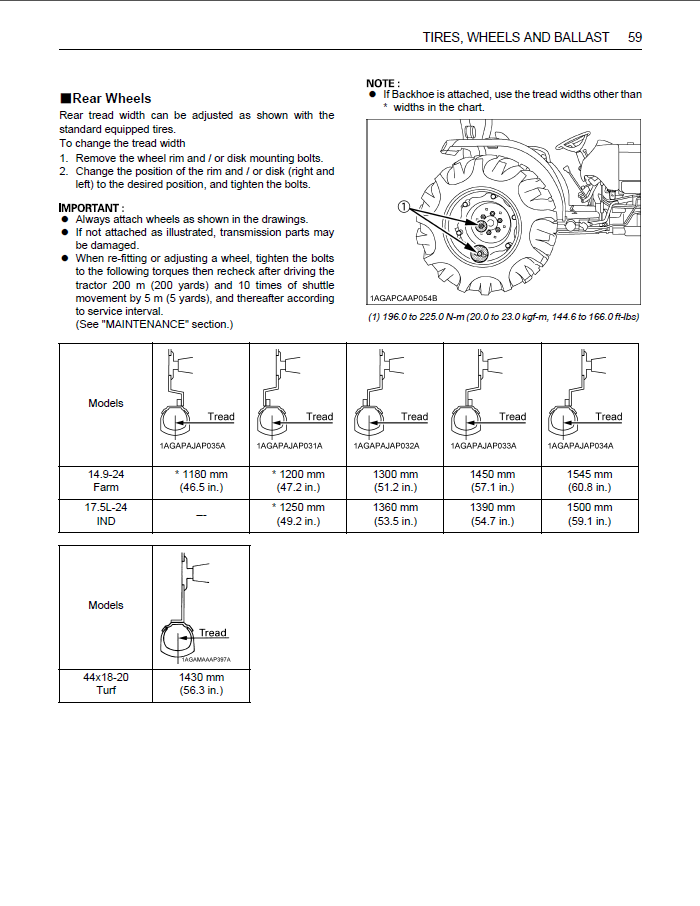

Here it is. Manual is from 2019.
I’d go with the metric dimension written in the manual rather than the imperial dimension. As long as they’re at least 1.5 millimeter apart you should be fine per the manual. Might have trouble hooking up the PTO but the manual says 1.5mm is sufficient.
As snarky as that may have sounded, that’s what the manual you posted actually says and I think that’s instructive as to the reliability of that specific portion of the manual. 60” inside to inside between the tires with R4’s or turfs is absolutely ridiculous. You’re fine with them as is.
Not saying you can’t roll the tractor. Some people can roll a Timberjack running high flotation duals. If you’re mowing stuff that’s got a good bit of slope, loaded rears will help stability and remember up/down slopes to the degree possible, not sideways on slopes.
1.5 mm would be incorrect also.
I'm assuming it means 1.5 meters. 1.5 meters is 59 inches.
1.5 mm. = about 1/8 inch
1.5 meters, maybe? Which happens to be almost 60 inches!
That’s the point. 1.5mm is obviously wrong, but that’s what they put in the manual. 60” is almost as clearly wrong as 1.5mm.
