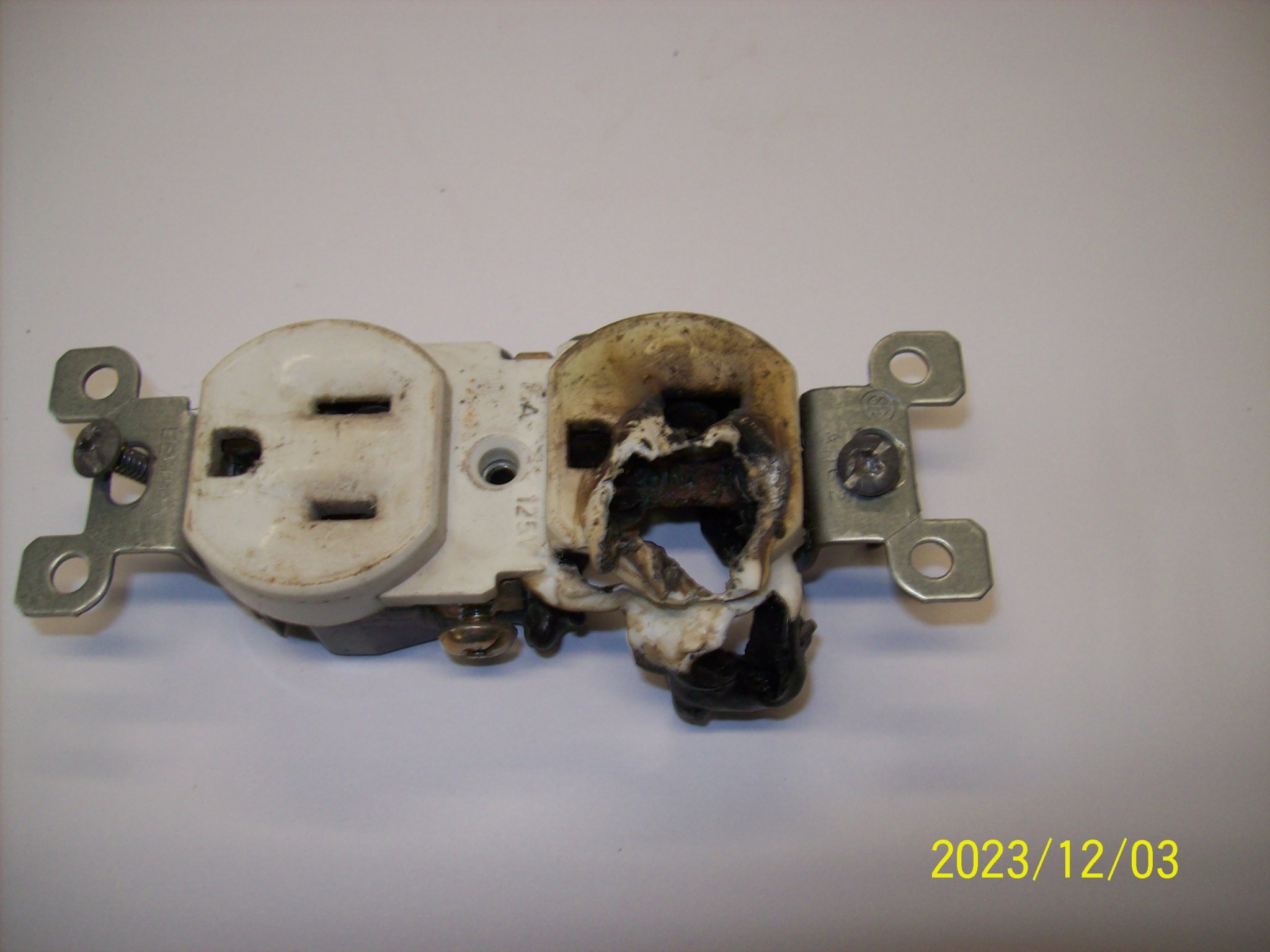

neighbour asks if I can replace a 'split' receptacle, that he's only using 1/2 of....
...for some 'strange' reason.....
I wasn't busy, had the parts and time...

Did he happen to say what he was using in the plug 😳😳😳
I've seen them give up the smoke before, but dang.....

The breaker should have tripped long before that happened to the receptacle.

Of course if was on a 20 amp breaker those wires could have burned a lot longer :)
Just think of plugging in an electric heater and the considerable heat it makes, then you will know why the breaker didn't trip since it was only resistance and not a direct short.

So many want to bash Arc fault and Ground fault breakers but this is one prime example why they are needed.
That's not a short that will trip a breaker, it's and arc, and it just keeps going till the arc reaches a gap that's to large to bridge and quits.
Most of the Arc faults are hidden and will arc till they start a fire and burn everything down.

1500 watt IR heater was the load. The 'problem' is the receptacle is mounted horizontally, so every time he move the cord the 'blade' opens the gap in the receptacles contacts. Over time a real 'gap'..bzzzzz.poof.
Located in old skool plaster walled cooler,so ne real fire hazard,luckily
