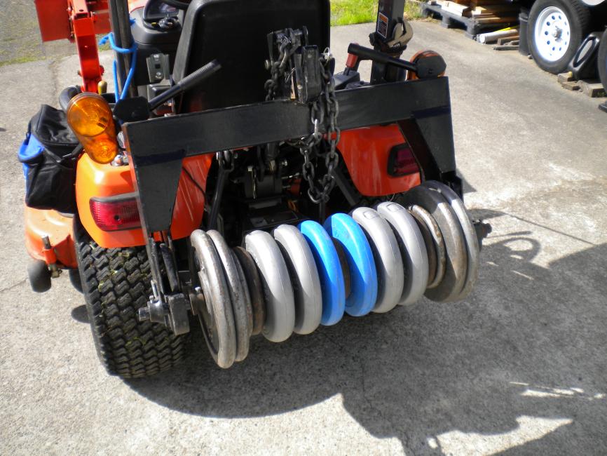

I do mow with the extra weight on the tractor 3pt. It helps lower the COG when mowing along the drainage ditch along the road in front of my house. Without the extra weight the tractor tends to slip sidways into the ditch. The extra weight gives me just enough extra traction that prevents the sidways slip. Here is a picture of the weights.

Looks like you've got that weight low enough to help for your situation, nicely done.
