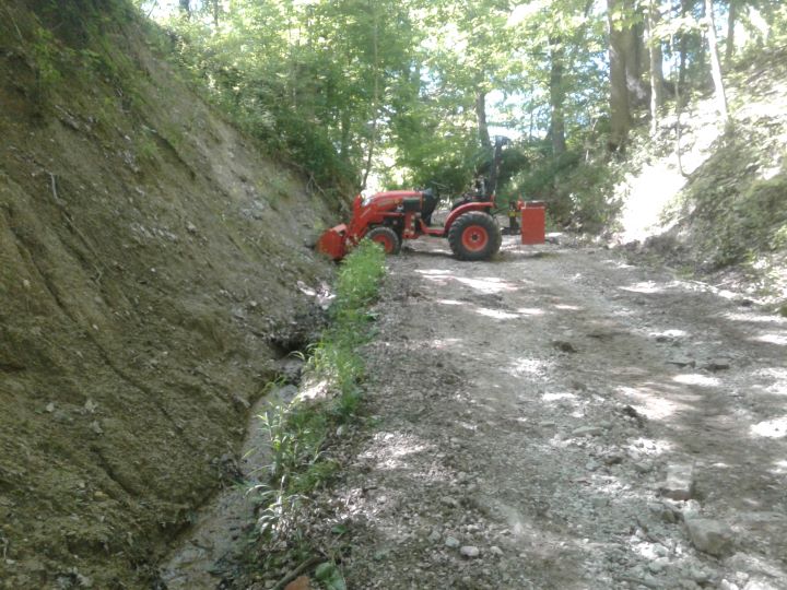

Tire slippage with ballasted tires usually are a result of low air pressure. PSI has to be real low before they look flat. Most people use 3pt weight/ballast to gain FEL lifting power. Ballasting tires makes it harder to roll tractor over on it's side.
Cleaning ditches with BX and air filled tires is a real white knuckles experience. Doesn't take long to order a "B" series with loaded tires.
