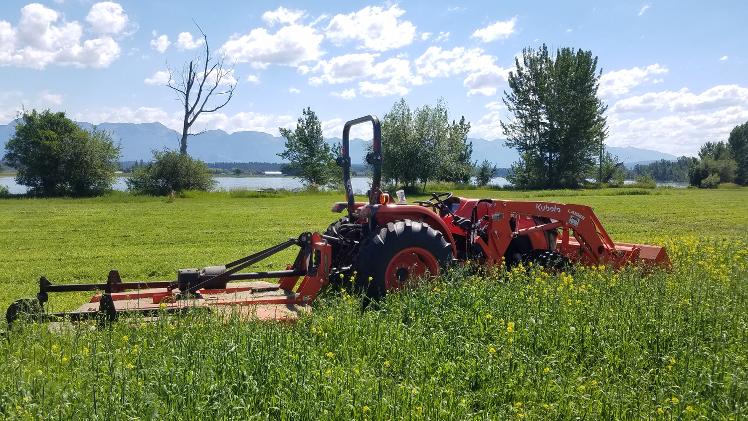

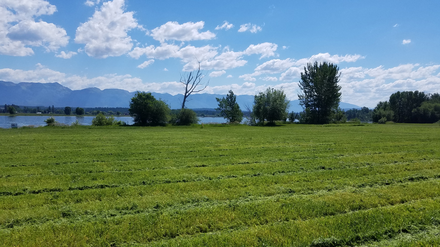

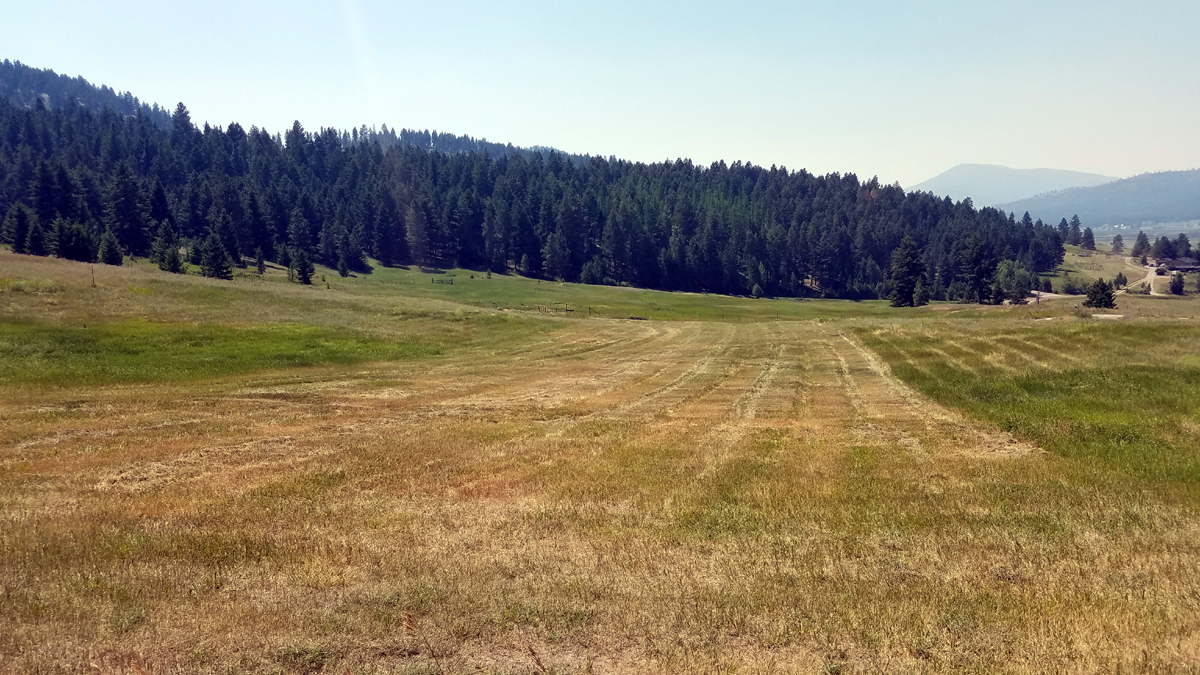

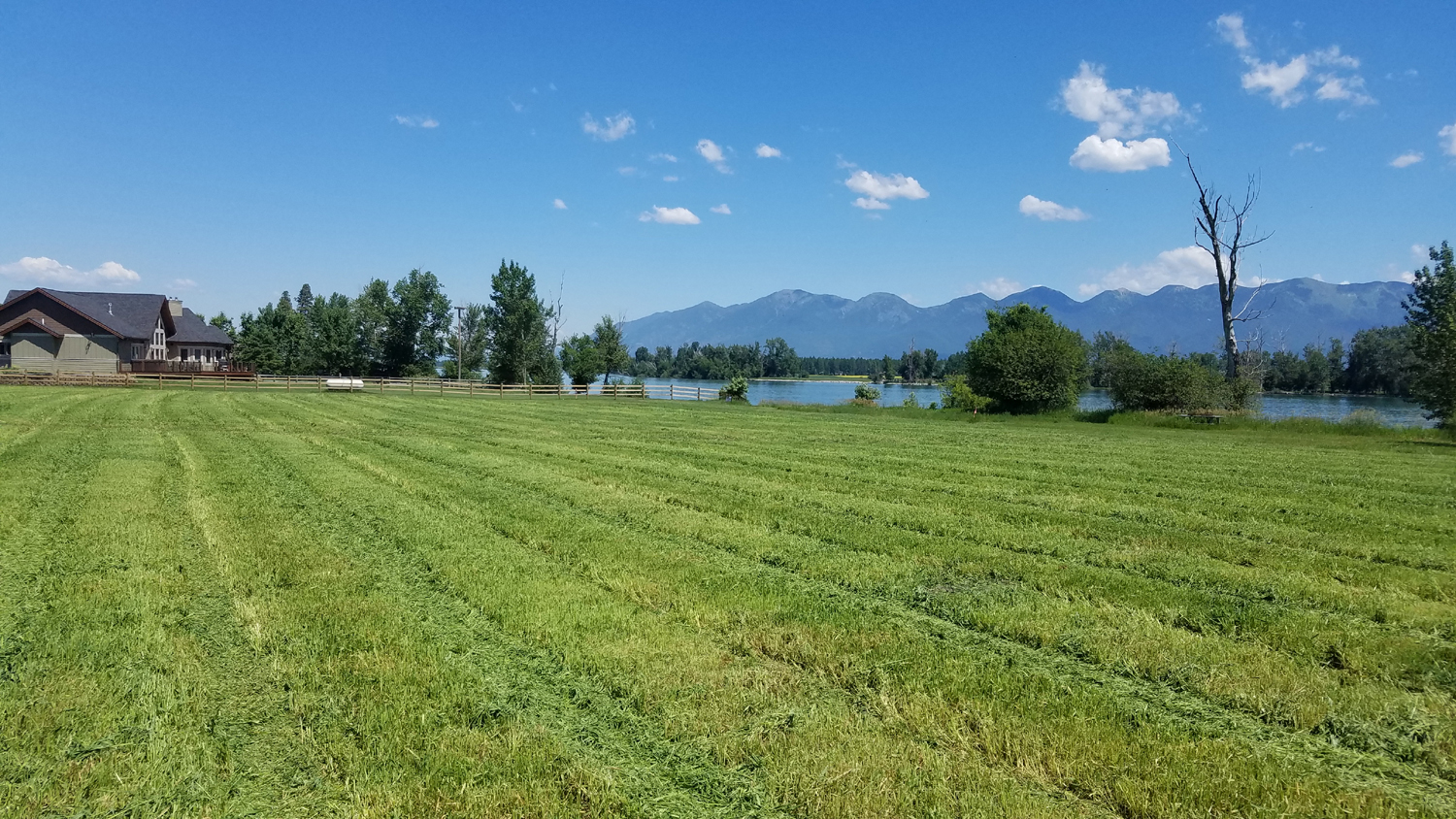

I don't have much to add other than give a shout out to Land Pride cutters. I continue to be impressed by the RCR1884 I bought a few months ago. At 900lb it's a beast and arguably the most used implement I own. I bought mine for much the same reason that @jimh406 bought his i.e. to cut pastures that are hilly and bumpy ... and also cut friend's fields it seems. What surprised me is how decent a finish these rotary cutters produce when used as rugged lawn mowers. I could have cut the field shown below a lot lower but it was my first time there so was playing it safe.
I do wish that the grease fittings were easier to access and that removing/installing blades was easier but neither are deal breakers.
I have the loader and bucket on my MX when mowing (about 1,800lb) and balance has not been an issue at all. One thing I've noticed though is that I'm not sure I could get on/off my trailer with the cutter hooked up if I didn't have top-n-tilt.

Yes, my friend is very fortunate being on the Flathead River. I'm cutting about 8 of his acres (going back on Saturday) and I think he has 20 overall. There's a 1 acre lot for sale with its own dock next to the house in the third photo if you're interested. :)
He took me up in his plane for 2-1/2 hours a couple of weeks ago and then fishing on the river the following evening after making me dinner. I told him "you sure know how to show a guy a good time!" We laughed quite a bit over that. I'm not much of a fisherman but caught three Crappies and it was gorgeous sunset as we headed back to his house.
The flying and fishing are all directly related to me buying the MX and RCR1884. Who would have thought.

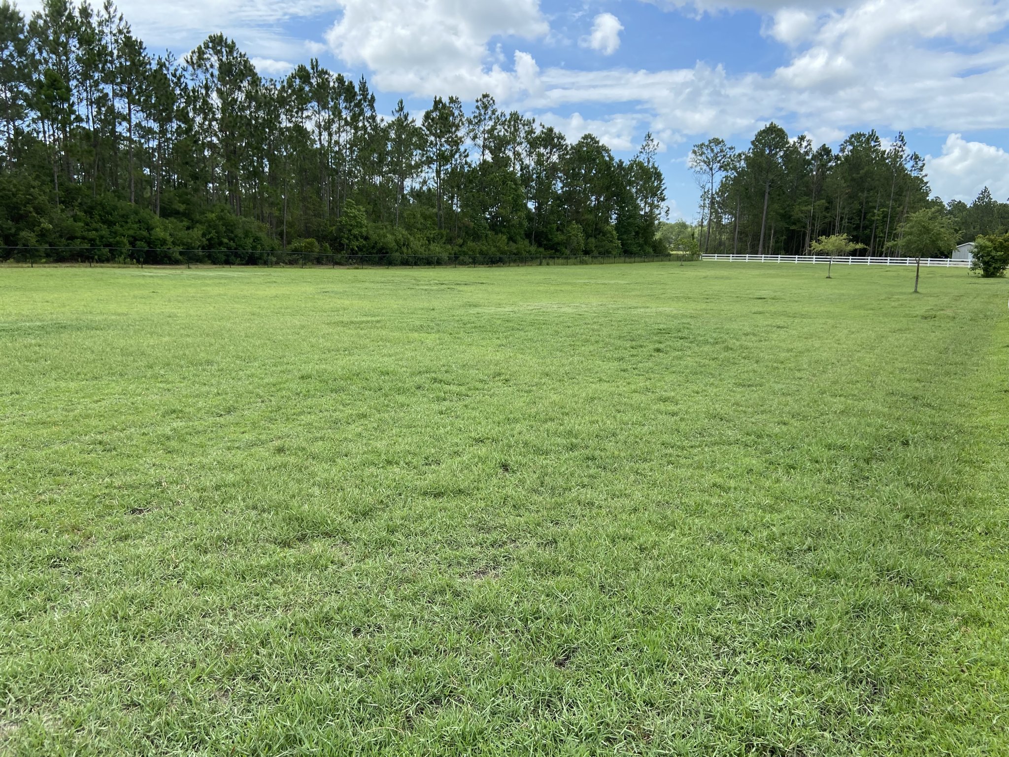

This my pasture after a round with the RCR1860. I will second the endorsement of LP rotary cutters. At least the 18 series. Very happy with it.

I would love to have a pasture as nice as that! That LP sure does a great job! I bet your 1860 would take those trees down if you wanted! 😂

Wow! That pasture looks like it was cut with a finish mower. Looks fantastic!

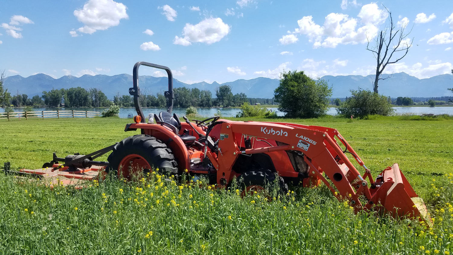

Here's some of my field that I stated to cut the other evening. I'll get back on it this weekend but sure wish I had the cabbed tractor already ... for the dust and the smoke ... and the heat!
