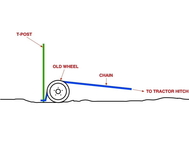

We wrap a chain around the bottom of the t post and then lay the chain over an old tire that will hold air, that is right up against the post. Hook the chain to your draw bar and pull. The tire will allow the chain to pull straight up on the post and should give you leverage to pull it out. The air in the tire gives a little cushion so that the chain hopefully doesn't break. We pulled an old cb antenna tower out of the ground like this and it was in the ground at least 6', probably more.
7,523
2,556
What Doc said.
I've used an old rim (no tire) to do the same thing.
