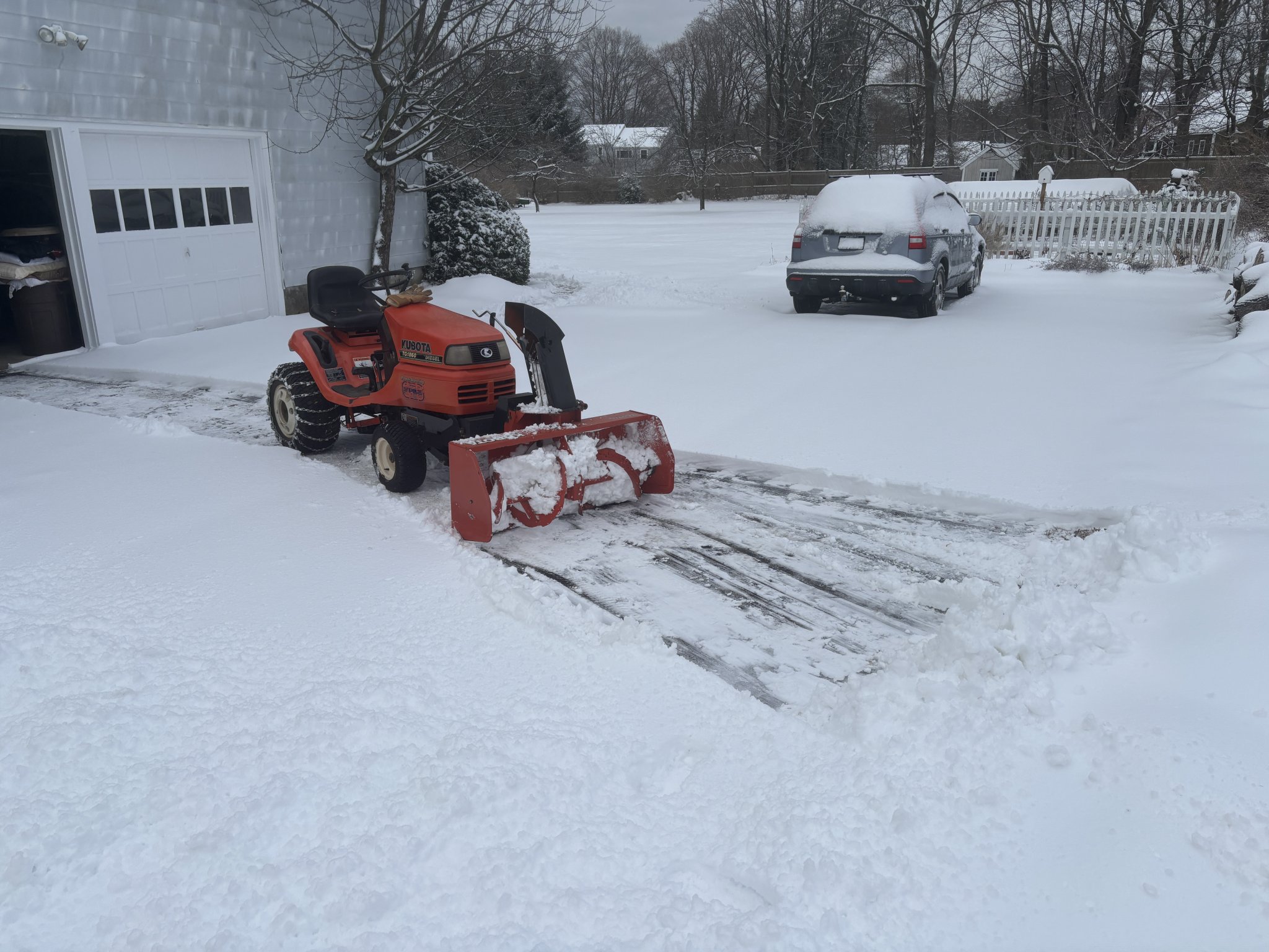

Went out this morning to blow snow. Chute clogged after about 30 seconds. Ten minutes to clear. Clogged again. Photo shows how far I got. Our snow is simply too wet. Ended up using it as a plow - not very efficient. Lift also seems not to work. If I lever the snowblower up with 2x4's the lift lever will hold the blower up when I remove the wood, and lower down when I release the lever. The blower is too heavy to lift by pulling back on the lever itself however. How is it supposed to work? I do have the "extra" handle that does not appear in any of my instruction manuals. Do I need to add that to the mix?

Went out this morning to blow snow. Chute clogged after about 30 seconds. Ten minutes to clear. Clogged again. Photo shows how far I got. Our snow is simply too wet. Ended up using it as a plow - not very efficient. Lift also seems not to work. If I lever the snowblower up with 2x4's the lift lever will hold the blower up when I remove the wood, and lower down when I release the lever. The blower is too heavy to lift by pulling back on the lever itself however. How is it supposed to work? I do have the "extra" handle that does not appear in any of my instruction manuals. Do I need to add that to the mix? View attachment 148039

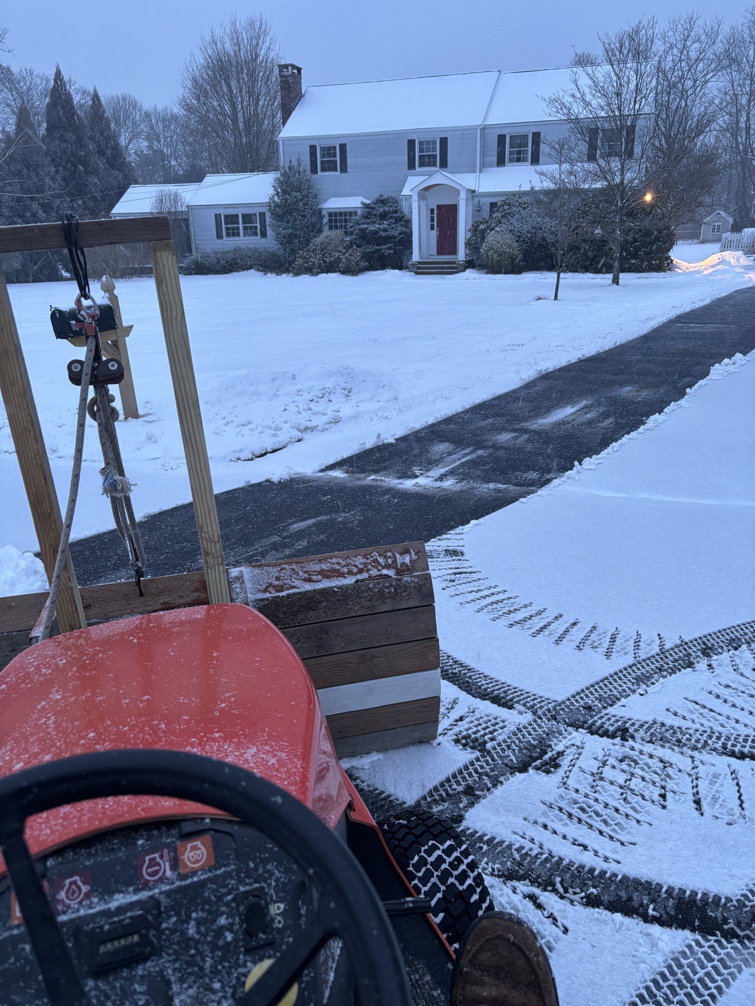

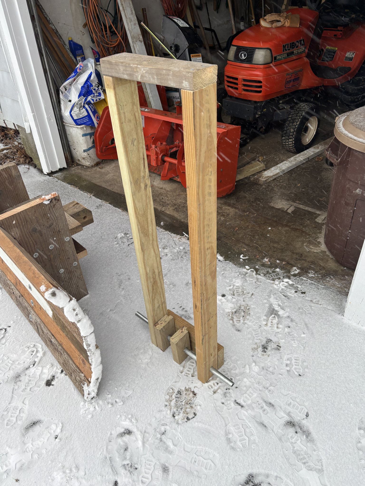

After snowblower debacle decided to look (again) for a plow: TG2748 or TG2754. Closest ones are hundreds of miles away and come with hydraulics that my tractor does not have and add unecessarily to the cost. Decided to build my own plow out of 2x lumber I had on hand. More snow coming would delay any shipments anyway. Here we are:

Take the guard out of the chute and it will help tremendously with the plugging. That’s the first modification most on here have done with their snowblowers. Spray down with cooking spray and run tractor wide open throttle and I bet you will find that you can blow that snow.

Removing the guard is an idea. Does it help tremendously because it makes the chute easier to unplug or because it makes it less likely to plug? Already running wide open with cooking spray galore at a snail's pace.
Putting the blower back on is a hassle and a half so may need to wait until the plow rots to see if removing the chute helps. Some of the 2x's are pressure treated so it may be a while.

After snowblower debacle decided to look (again) for a plow: TG2748 or TG2754. Closest ones are hundreds of miles away and come with hydraulics that my tractor does not have and add unecessarily to the cost. Decided to build my own plow out of 2x lumber I had on hand. More snow coming would delay any shipments anyway. Here we are: View attachment 148563 View attachment 148564
I love the ingenuity sir!!!!
It looks like your transporting a "portable guillotine"........

It helps tremendously, because it hardly plugs, or at least that’s the way it is on mine.

Thanks for the input. Will take it off before trying it again, though if the plow keeps working well the snowblower might be for sale.
