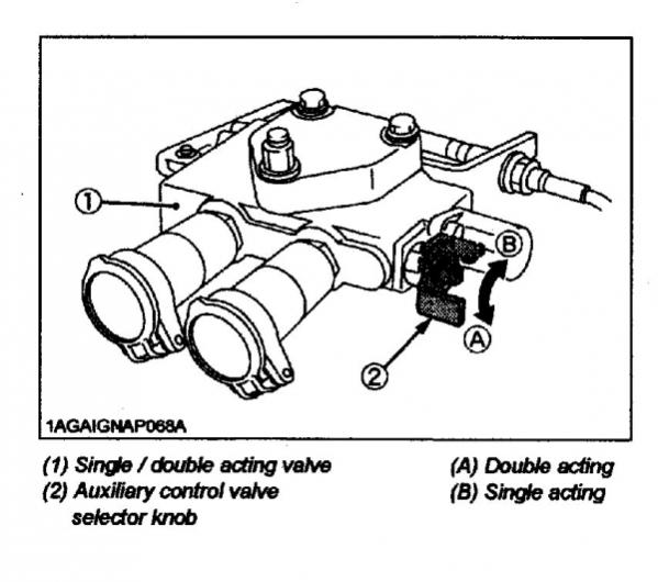

Also check the auxiliary control valve selector knob on the side of your remote valves (between single and dual acting) if you have them, as if it is mid position it will probably bleed oil back to tank.
