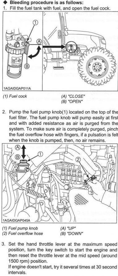

Changing the fuel filter an separator and don't want to break anything. There is a plastic round knob on top of the filter housing which I think it would normally be a primmer pump. Tried to loosen but seems either stuck or there is a pump somewhere else.

Maybe I just need to pump it more but the plastic thing (pump piece) doesn't move very much (3/8 inch or so) and I feel something in the center when it goes down. I have CAT dozers and backhoe and they have a pump also but it moves more then this one.
Guess I need to just pump it more and see if something happens

I realize on diagnosing most problems tractor type/SN is very important factors that need to be known. The bleeding instructions tthorkil posted are very similar to whats outlined in operators manual for my M7040 HDC-1 so ""curiosity forces me to ask"" how many different methods/ways are outlined in operators manual are there to bleed fuel system on a M9540?

Air in the tank is an easy way, many do it that way, just don't want much pressure (under 5 psi and 3 is better)
My pump is on top the fuel filter housing

They change things on different models, and some have mounted in the line. Looks the size of a shot gun shell. If the motor is a 466 DTE then it can have an electric fuel pump, so you just turn the key on/off a few times.
When changing my last filter I pumped it a bunch until it finally came out the bleed screw. I'd post a pic but doesn't give me the option to upload, oh well :rolleyes:
Oh did go back out and pumped some more on the tractor and not sure if its doing anything, but 28*F and no need to fire it up now

Got the pump working. The piece in the center I was feeling when pushing down was a Phelps screw holding the plastic pump knob. The knob came off and I managed to get it reattached.
After tightening the screw, was pushing up/down and tried pushing harder downward. After a few attempts, it moved further down and I could hear and see air purging in the separator.
Sometime you just have to figure it out
