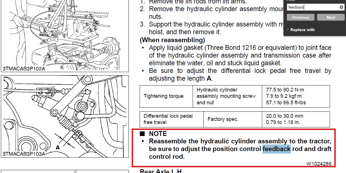

There will be a feedback rod connected to one of the 3 pt lift arms and at the other end connected to the 3 pt control valve. it purpose is to not allow the 3 pt to stay constantly calling for hydraulic pressure. If it is not adjusted properly the pump will he hitting the relief valve and over time heating the hydraulic fluid too high.

That’s good info Dave, thank you. Wouldn’t I hear the relief valve hitting though or am I overthinking this?
Have you ever heard the relief valve in earlier years?
Usually the engine noise drowns it out.
Running oil thru the relief valve is a quick way to heat it up.
You can always do as Dan suggests if you have the gauge and hardware

If not buy a gauge and tee - cheap and useful addition to any tractor owners toolbox. Takes a lot of the guesswork out.
