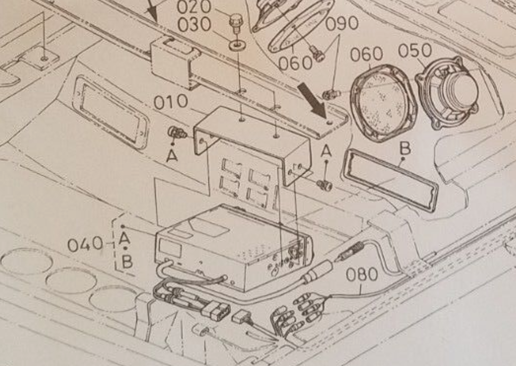

I own an 05 M9000, cab model, and trying to swap out the factory radio. It's giving me fits and doesn't want to come out. No bolts around the face (trim is popped off) and I tried depressing clips on side, but I'm not getting any movement.
Has anyone dealt with the m9000 factory radio? Am I missing something, hopefully easy?

It'd probably be easiest to pull the roof off to gain access to the radio cage and release the radio that way.
Can you find the radio you have on eBay? Pictures on eBay may help you "look behind the curtain" on how the radio comes out. Is it this one you have? https://www.ebay.com/itm/173499380693

I found the answer somewhere else. You have to remove the top, it is bolted in from the top with 2 bolts. Thanks for the suggestions.
