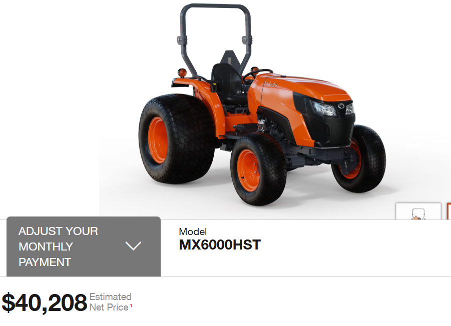

I would suggest an MX as it has HST and a fixed speed PTO.
or I would think he would look at one of these:
7,114
9,732
That MX6000 looks like the ticket!!!!
I have an MX and an M and it depends on the weight of the mower and the terrain. The M is way more capable pulling a heavy load over hilly terrain. While I agree with @North Idaho Wolfman and his recommendation to consider an MX6000, which is a very capable tractor, it does depend on the conditions of use. Is your friend cutting fairways or thicker, heavier stuff found in the rough?
I will say though, for employees who aren't experienced tractor operators, an MX or L60 would be a better choice. It's much easier to operate for most people who don't want to put in the effort to master a bigger, more capable tractor.
