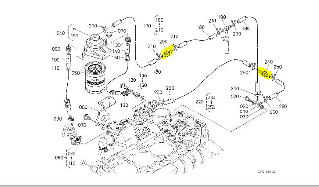

I once during cold weather experienced the fuel return line separate at connector on my '11 M7040. I rejoined the hoses & it's been fine every since. The fuel return line on my M7040 has a "round check valve" installed that I don't see in parts schematics

Can you please explain the need for check valve in fuel return line on a Kubota? I've never noticed a check valve on fuel return line on any other brand tractor I've been associated with. I know my JD & Ford tractors don't have a similar type check valve on return line.
Thanks,Jim
