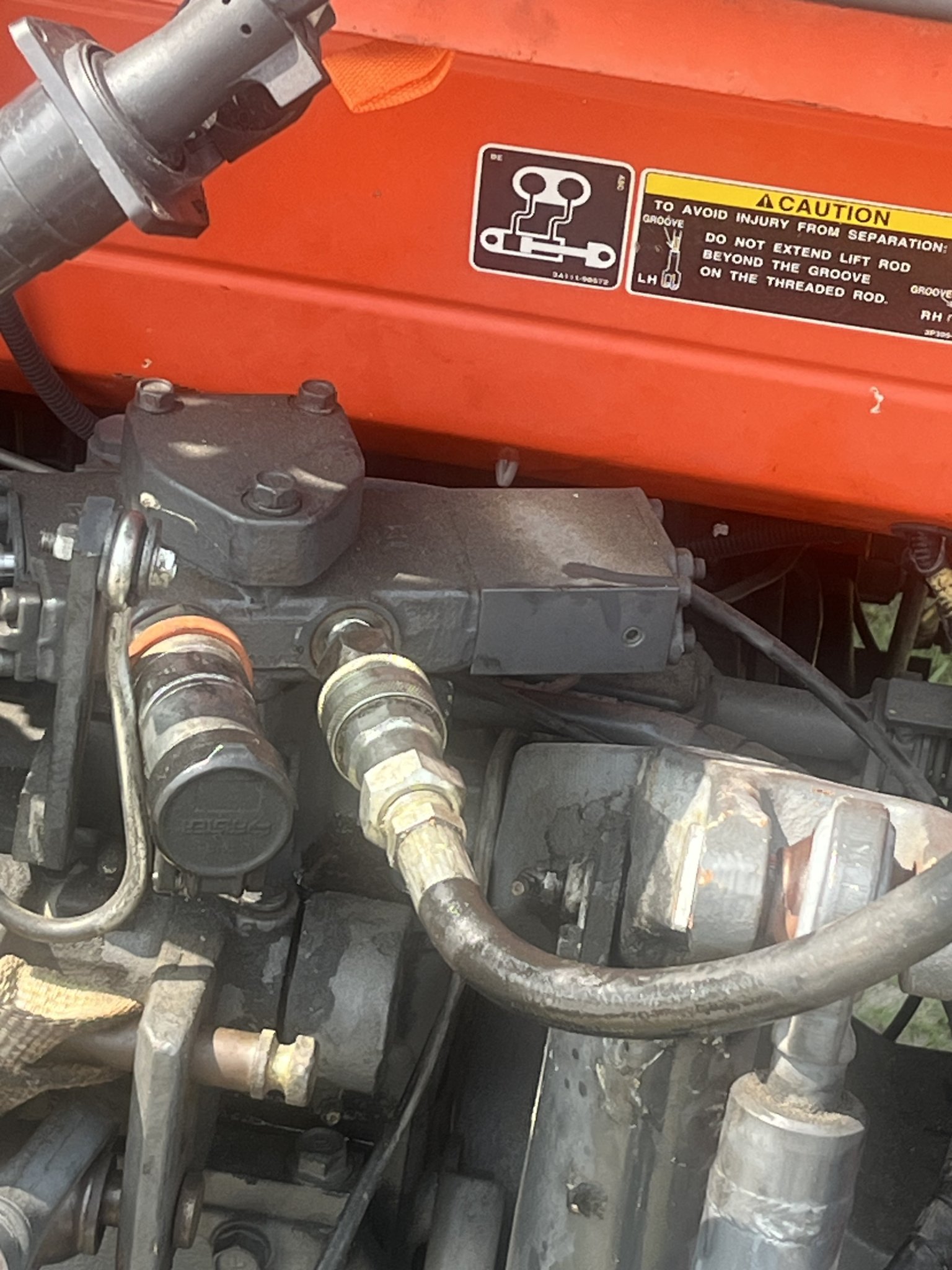

Is the rear remote hooked up to here?
And if it is can you get a picture of that connection?

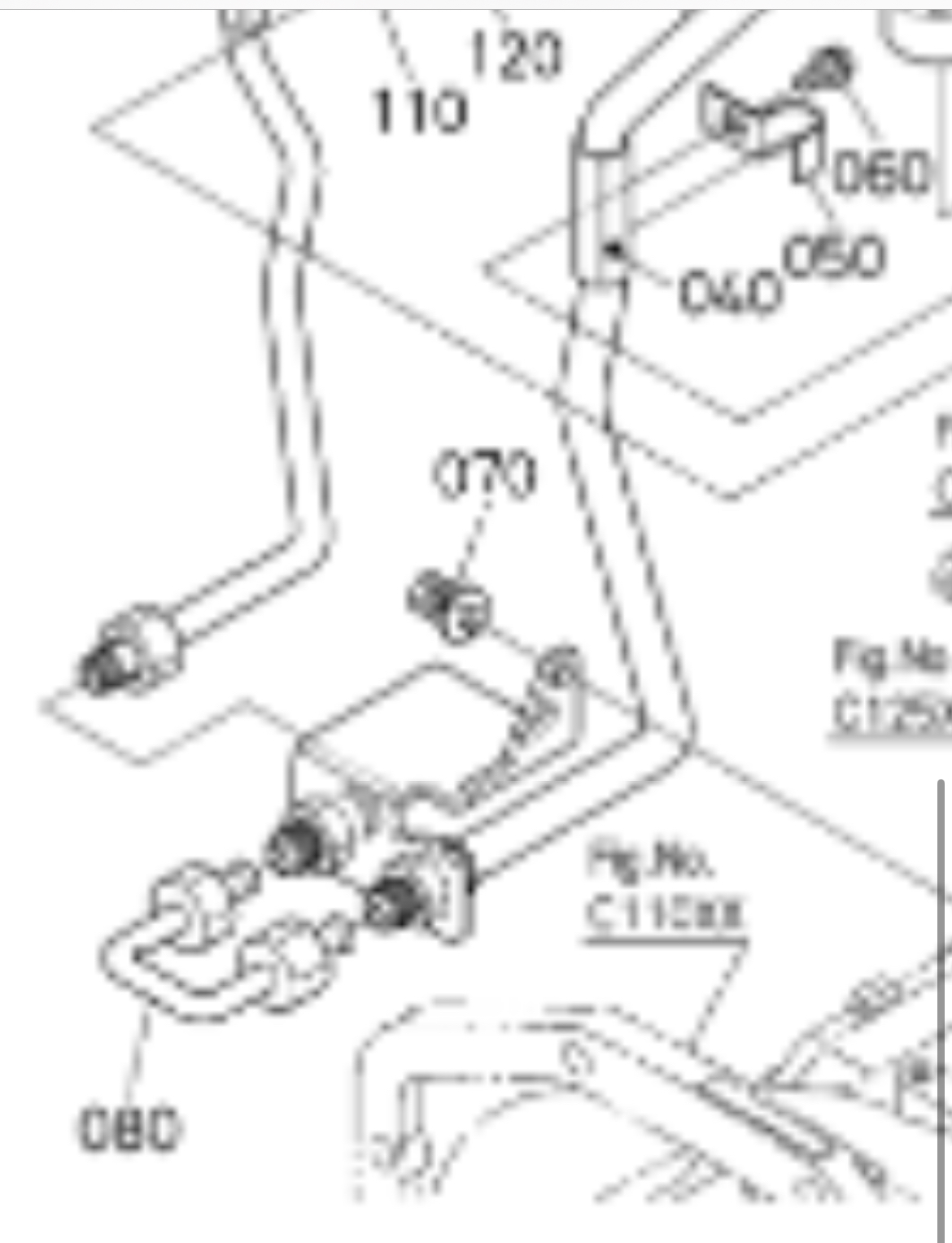

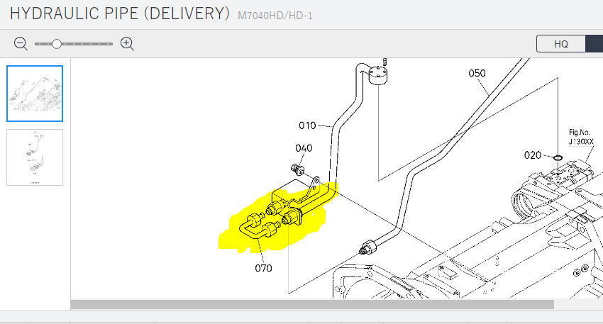

Picture of the other connection?
Does it have a block like the above picture or just a couple pipes?

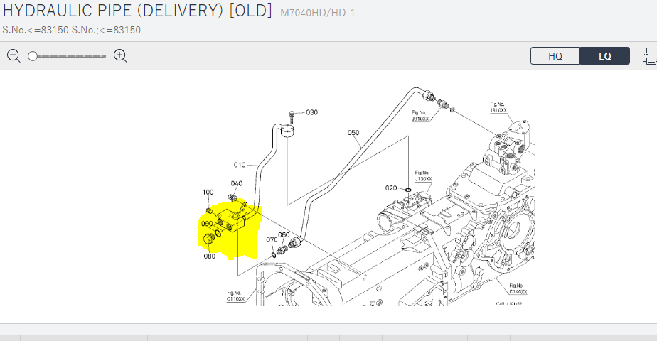

Per serial number you should have bracket and pipe and a loop.
Where are you taking the pressure measurements?

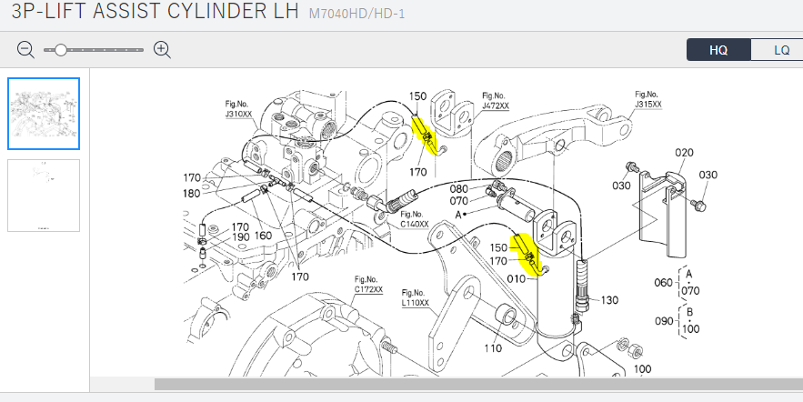

I took the pressure measurement at the 3point in the picture u sent
Which picture?
Do you mean in the WSM?

The picture I sent from the parts lookup with the pipe on it.
Did you put a tee in place of that loop and then operate the three point to test it?
If you just removed a line and pressure tested the pump output without a tee.
