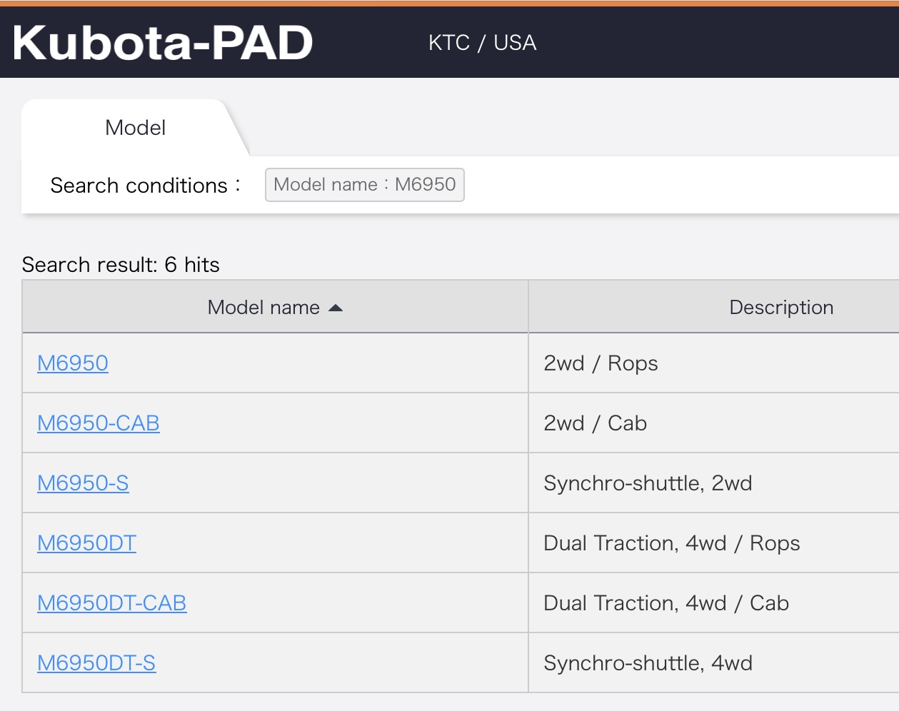

Going to the illustrated parts list at this site
and searching for M6950 you get these results so you may be able to eliminate some. The biggest differences may be in the synchro shift version versus the others so hopefully you know the differences in how it shifts OR there may be a label on the tractor that shows the model and serial number.

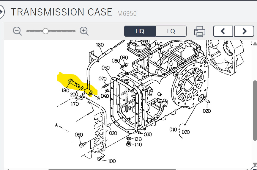

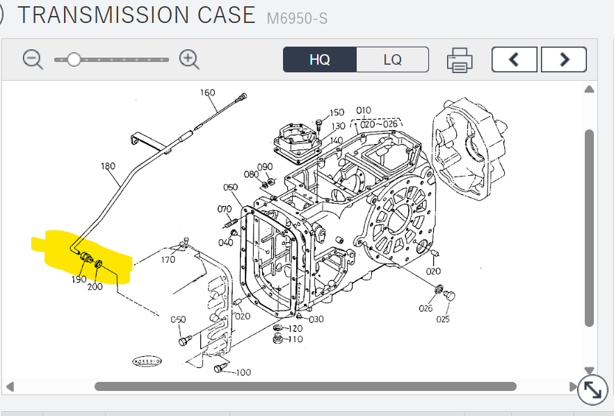

The M6950-S is shuttle shift, parts will be different, and testing might be different.
Look at this dipstick detail to be able to tell which model you have.
This is a M6950
This is a M6950-S

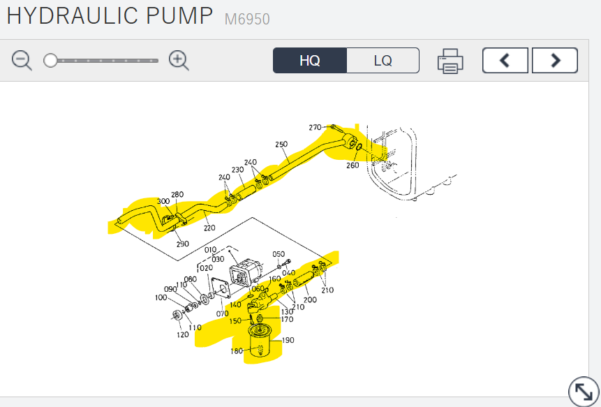

I would start by checking the suction side of the hydraulic system.
Look for wet spots.

I didn't even see your reply lol, but after digging into it I've traced everything to the hydraulic pump or like you said a leak in the suction lines, the pump seems to work fine then when running the pto using my hog, at random times it seems like the pump just loses prime and fills the system with air, the 3point quits and the PTO sticks on regardless if it's engaged or not I can disengage it via the lever but not the switch on the console, I can't find a leak in the suction lines but obviously that doesn't mean it's not leaking, im hoping it's not an internal problem with the pump I don't want to spend however much W/O making sure it's not a leak.
