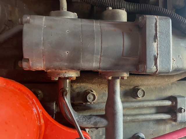

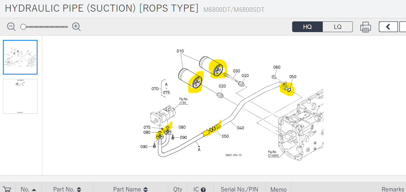

If I can get the small set screw type plug out of the steel line under the hydraulic pump and I use air to blow line back to transmission case will that work/ or do I need to disconnect both steel line flanges from under the pump.

I'm thinking I should get Part 050 Orings - break the line and check it out.

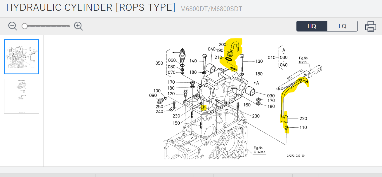

The O-rings in-between the steel line sections >. I can't see that joint because of the loader frame there.
How are those lines coupled? Nut and flared fitting?

The fitting is just a slip fit.
