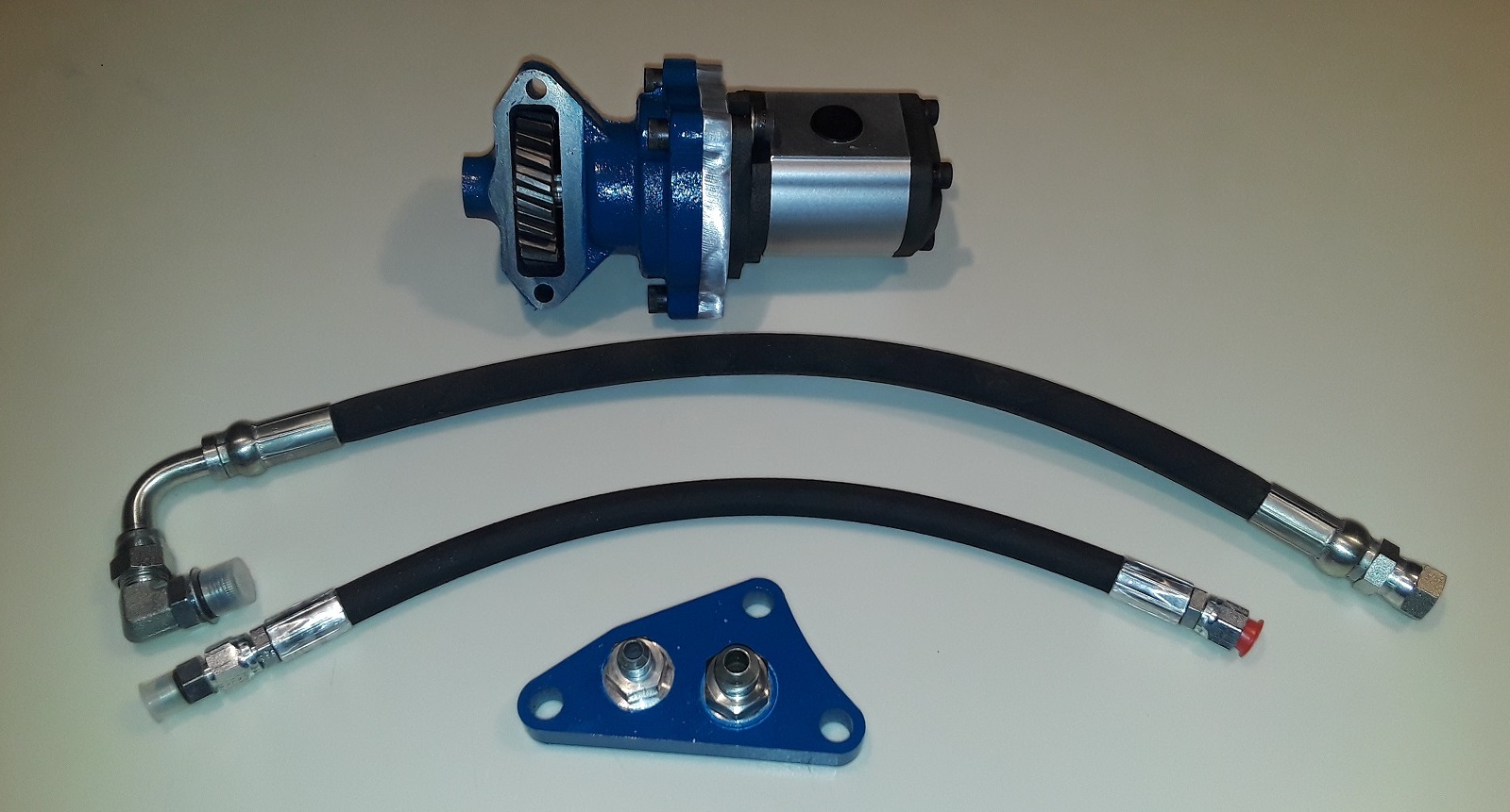

Not just the gear tips - the housing is softer and wears as well. I came up with an inexpensive gear pump retrofit for old Ford tractors and have dozens of very happy customers that wasted many hours and lots of money trying to rebuild the OEM pumps with new gears, pistons, vanes and rotors. DFW because the housings are worn oversize.
About the only thing worse than particulate contamination for hydraulic pumps is oil starvation. Both are untreatable and usually fatal.
Does your Ford aftermarket pump fix work for the Ford/Shibaura tractors?
7,246
3,538
No. Its a replacement for 1953-1964 Ford NAA Hundred,, and early One/Two Thousand series tractors with the OEM vane or piston pumps. I did one for a later 3000 series tractor but the plumbing on it is a royal B to hook up. Interestingly that was a one off for a Kubota dealership and the owner got me interested in the L3901 which I eventually wound up buying.
6,936
4,364
Thanks!
