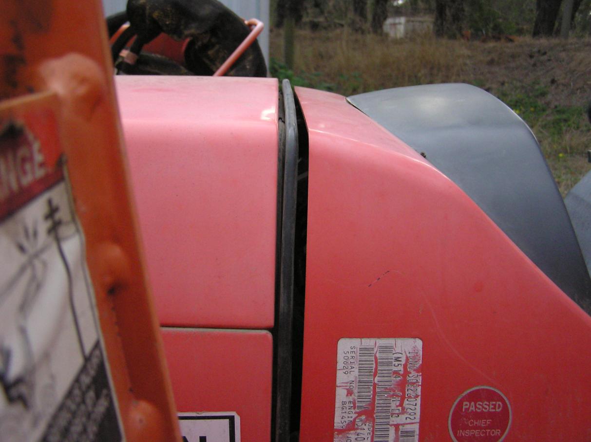

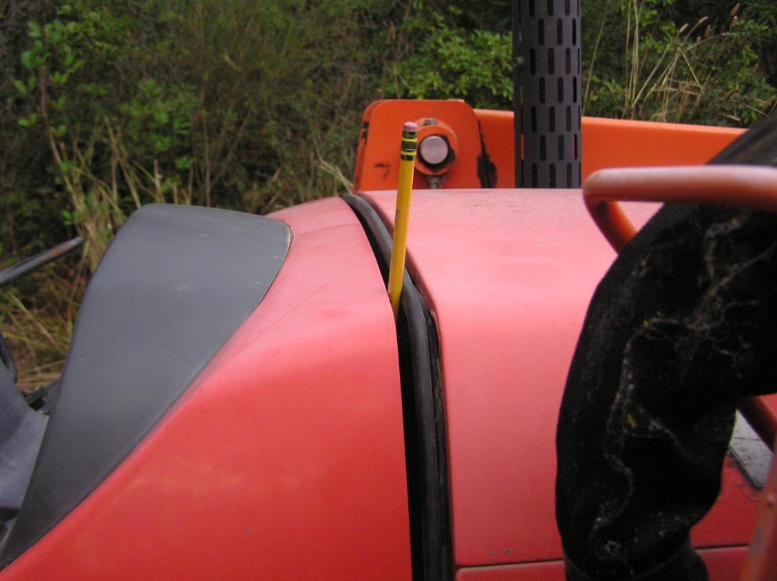

I just bought a used M5140 appears to be a 2012 660 hrs that has a gap between the instrumnent panel clear cover and the rest of the main Dash housing. Gap is about 1/4 inch were moisture and dirt can get into to area. It looks like the entire dash HOUSING is not up tight against the engine firewall. I am going to try and post some pictures. Anyone know how this should be repaired ? I seems that the entire housing needs to be screwed up tight so it fits tight to the engine firewall. Thanks for any help or suggestions. Bill

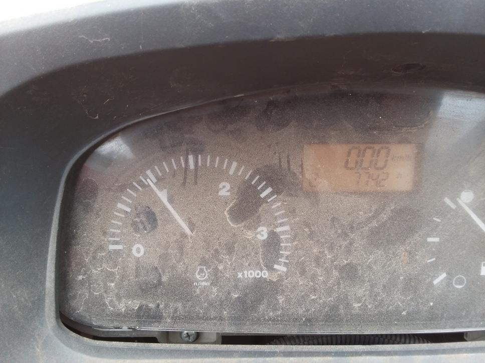

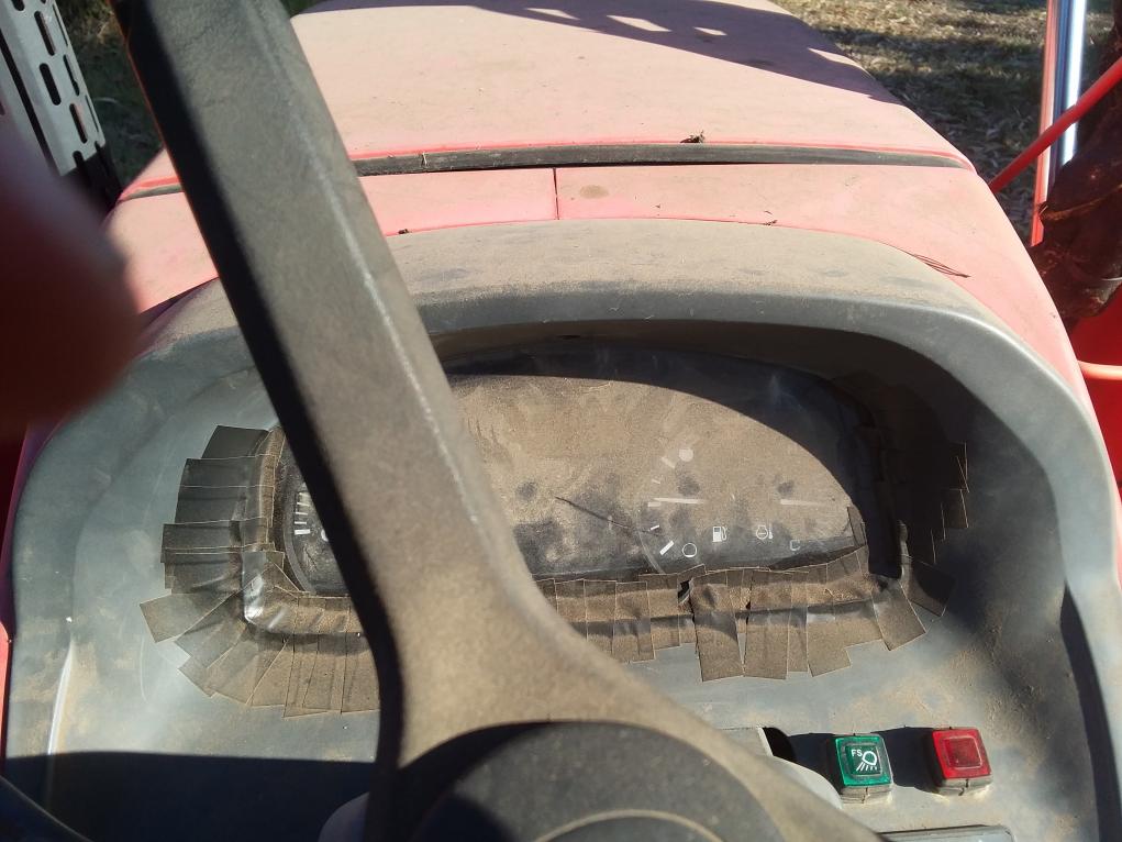

I was working in a very dusty environment, So I did a down and dirty in the field temp fix. Pictures Before with the large gap & after the temp fix
