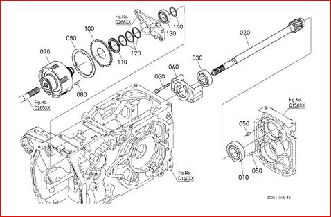

Your tractor is a independent hydraulic PTO clutch (so the main mechanical clutch has no effect on it's operation) and the Clutch pack is right in front of the differential (#70), you would need to split it just in front of the rear end to get to it.
Thanks for this info. I believed it to be an IPTO clutch as the PTO remains live when I clutch to stop. I thought I would try to fix it, thinking removal of the rear cover of the axle around the PTO shaft would get me to the area I needed. However, from I learned from people on this forum kind enough to give me some advice and what I found looking at the parts diagram, I thought I would have to split it to get to the PTO clutch. I am going to check with a dealer because, like everybody else putting up hay, I needed this thing fixed yesterday. I also know if I have to split it, the dealer has the tools and expertise to do the job quickly, where I would have to muddle through. Anybody with experience in mechanics knows there are always little tricks that come with experience to make a job easier. As an example, I remember putting an alternator on a diesel Toyota and finding a small groove that you had to line up correctly to remove a bolt. The dealer told me you had to disconnect the engine mounts and jack the engine up, eating up 4-5 hours for a 1 hour job.

It's a pretty simple system. Hydraulic activated through a valve applying hydraulic fluid through the manifold(piece labeled figure d26XX) #120's are sealing rings sitting in groves on part#70 which then in gauges the piston to apply power to the clutch.
The knocking noise could be a bearing that supports the PTO clutch assembly or related shaft. My past experience with hydraulic clutches. Piled up or warped separators or discs, bled off due to worn manifold or sealing rings.
Not a lot of choice but to split the tractor at transmission/rear differential housing and inspect for damaged parts.
A service manual would be wise if you are going to tackle it yourself. Or if the dealer where going to order your parts may copy or lend theirs?
