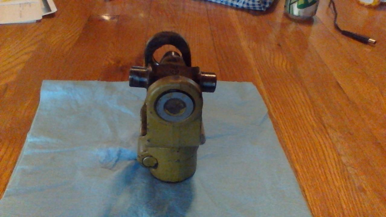

28,698
5,118
Looks to me like the yoke is bent on the other side? :confused:
Regardless of the issue, changing it should help! ;)

Damage like that could come from shipping, handling, over torquing with a high HP tractor, or just bad QC, at the factory. Them IR thermometers sure is the bee's knees at finding all sorts of problems. Usedta cost around $300, saw an ad last week, for $19! :D

I would never thought this could have been the problem...:mad: If I attached the pic :confused:hopefully you can see, the yoke bore is actually off center.
I just found one just like that on my batwing. I went to TSC and they didn't even come close to having one big enough so it was off to the driveline shop. After talking to those guys bent or twisted yokes are a very common issue. They said the yoke is one of the first weak links purposely made that way to help save the drive shaft. Like the man said, would you rather spend $50 for a yoke or $300 for a drive shaft.
