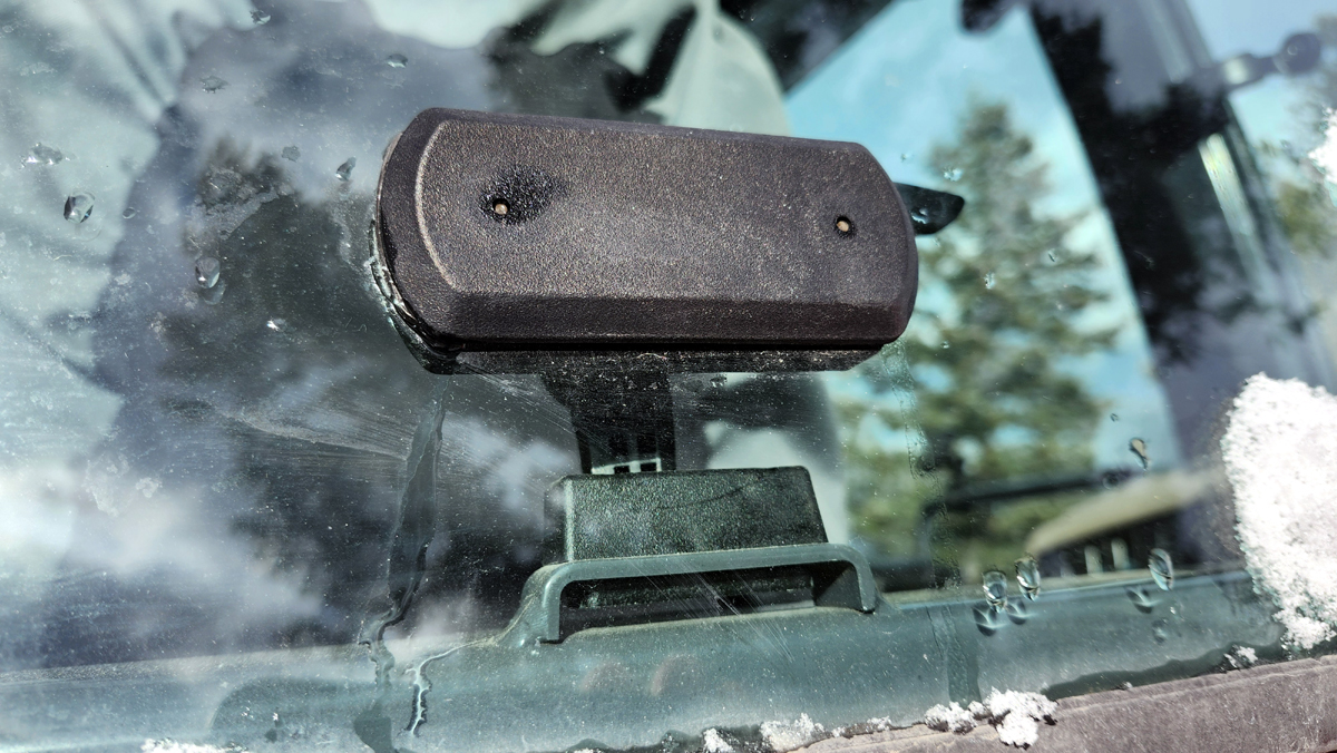

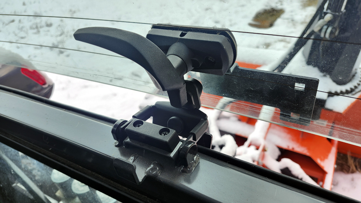

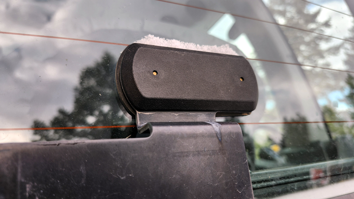

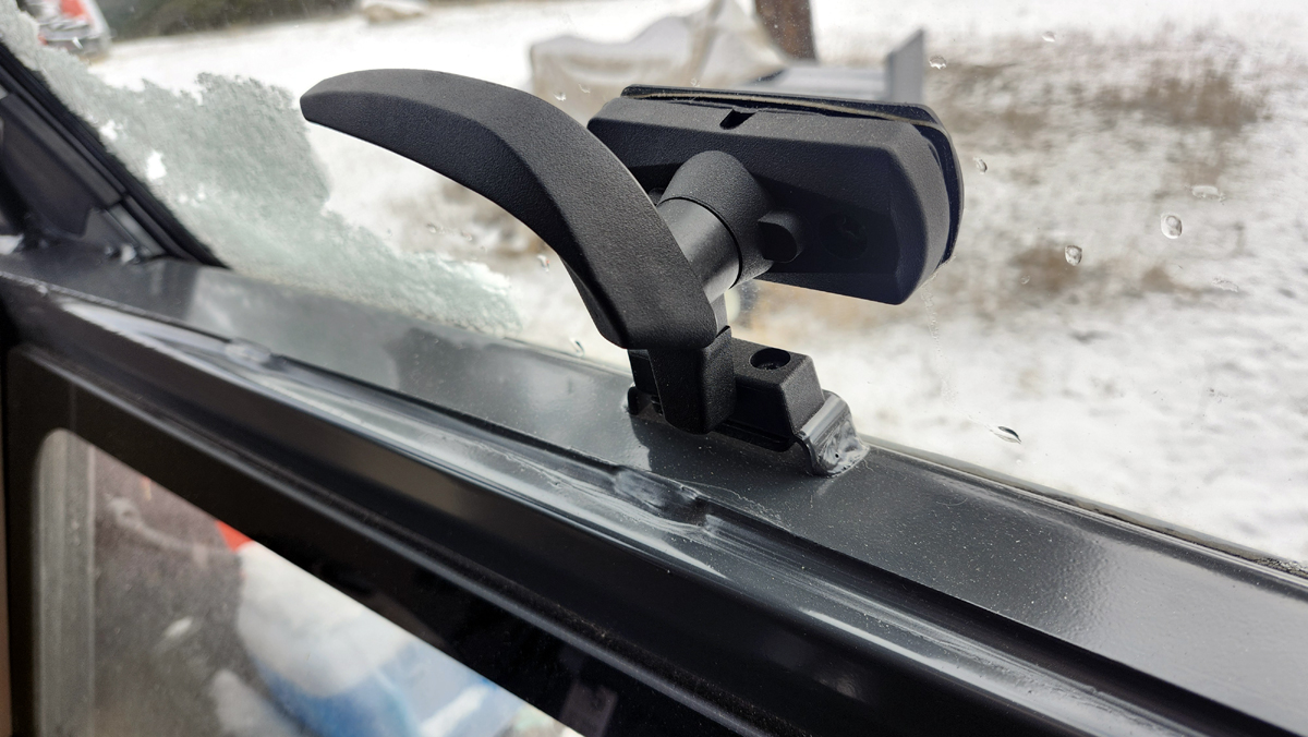

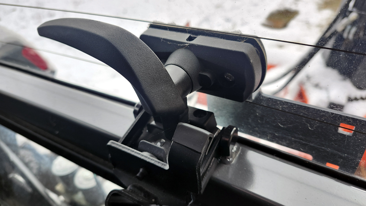

@Jerferrera, I took a closer look at the rear windows of the M6060 and MX and there's good news and bad news. The holes in the glass are spaced the same at 60mm but the MX has a much more elaborate system to open the rear glass a little and secure it in place.
I think it would be possible to modify a tractor to work with the MX system but I can't say if the view is worth the climb. The MX doesn't have rear side windows so it makes sense that it has the rear latch feature.
M6060 latch "plate"
MX6000 latch "plate"
M6060 rear window latch
MX6000 rear window latch
MX6000 rear window latch locked in "cracked" mode
MX6000 rear latching mechanism
M6060 latch "plate"
wow... that's what I'm looking for... I just don't have the mounting pieces welded to my frame. I could add them tho. not sure what Kubota wouldn't add this to all tractors
7,874
11,099

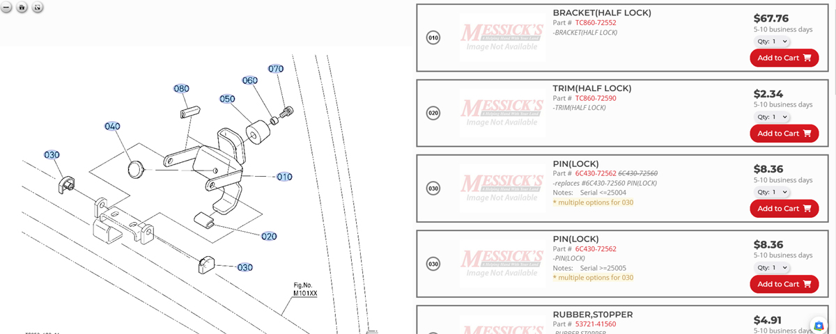

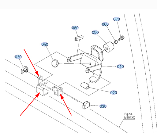

The assembly shown above isn't particularly expensive, maybe $100 all in, and you wouldn't have to weld on the three tabs shown below. You could make up brackets and bolt them to the frame if you added rivet nuts or similar. Lots of ways to retrofit the necessary interface to work with the half lock bracket.
The rear window latch in the MX and M are the same so it's possible that your Ms use the same latch too. You could order the half lock kit and see if you can make it work. It's a really nice solution that Kubota came up with for the MX which as I said doesn't have the side rear windows that the M has so it's the only way to vent the cab via the rear glass.
