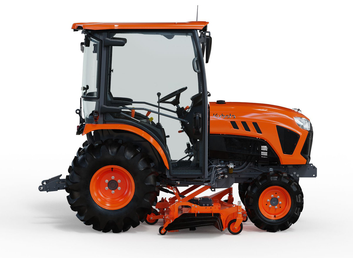

Once you shove a mid mount mower under an LX the weight discrepancy between it and an L with a 3-point or pull type mower in terms of ground pressure starts to shrink. The point about trailering is also not much of an issue given the weight of either. A 7k trailer would be fine for either with plenty of overhead for an implement or two.
The factory cab option on the LX is the biggest and most significant difference in my world.

The LX has quite a bit more 3-point lift capacity too.
A 3pt mower would weigh more than the belly mower in transport mode. The LX belly mower is ground contact, so the weight of it isn't on the LX wheels when mowing.
Different people have different needs. The LX is a reasonable amount lighter than the L - in fact, that's one of the limitations (as well as benefits) of the LX. Some people don't want to haul as much as an L, for other people it doesn't matter. Horses for courses.

According to the spec sheets on Kubota.com the difference in 3-point lift capacity of the L3302 is 1,998 lb at the lift points compared to the LX3520 which has a capacity of 2,535 lb at the lift points. The capacity of the LX 24" behind the lift points is close to the capacity of the L at the lift points.
Good to know. I thought the wheels were the standard anti-scalp variety. That mid mount mower is an expensive option at $3,700.
It is. But it's 72 inch and very heavy duty. It'll take way more punishment than any box store rider will. If you're dropping the money for an LX with a cab, the mower isn't really that much more.
