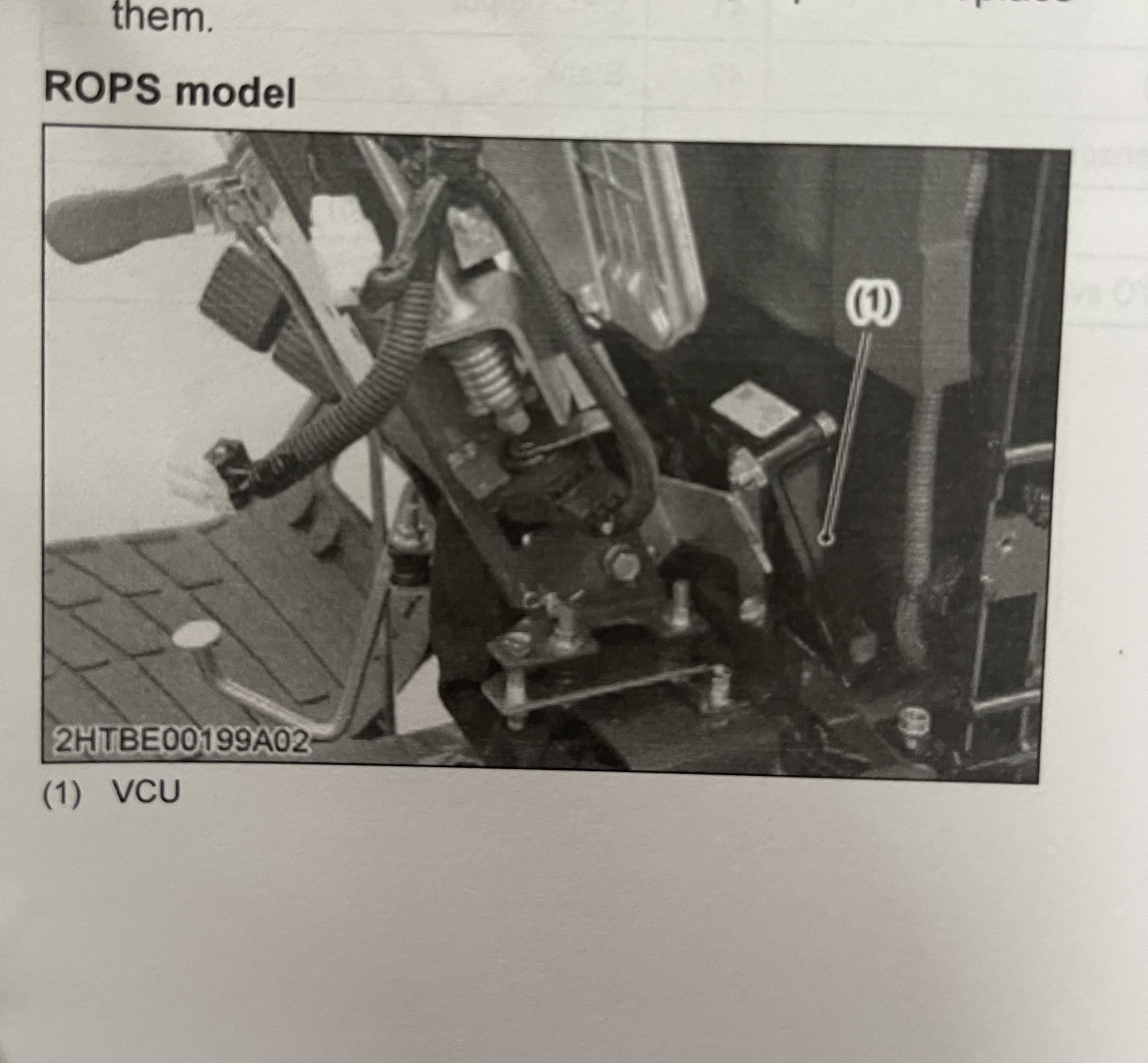

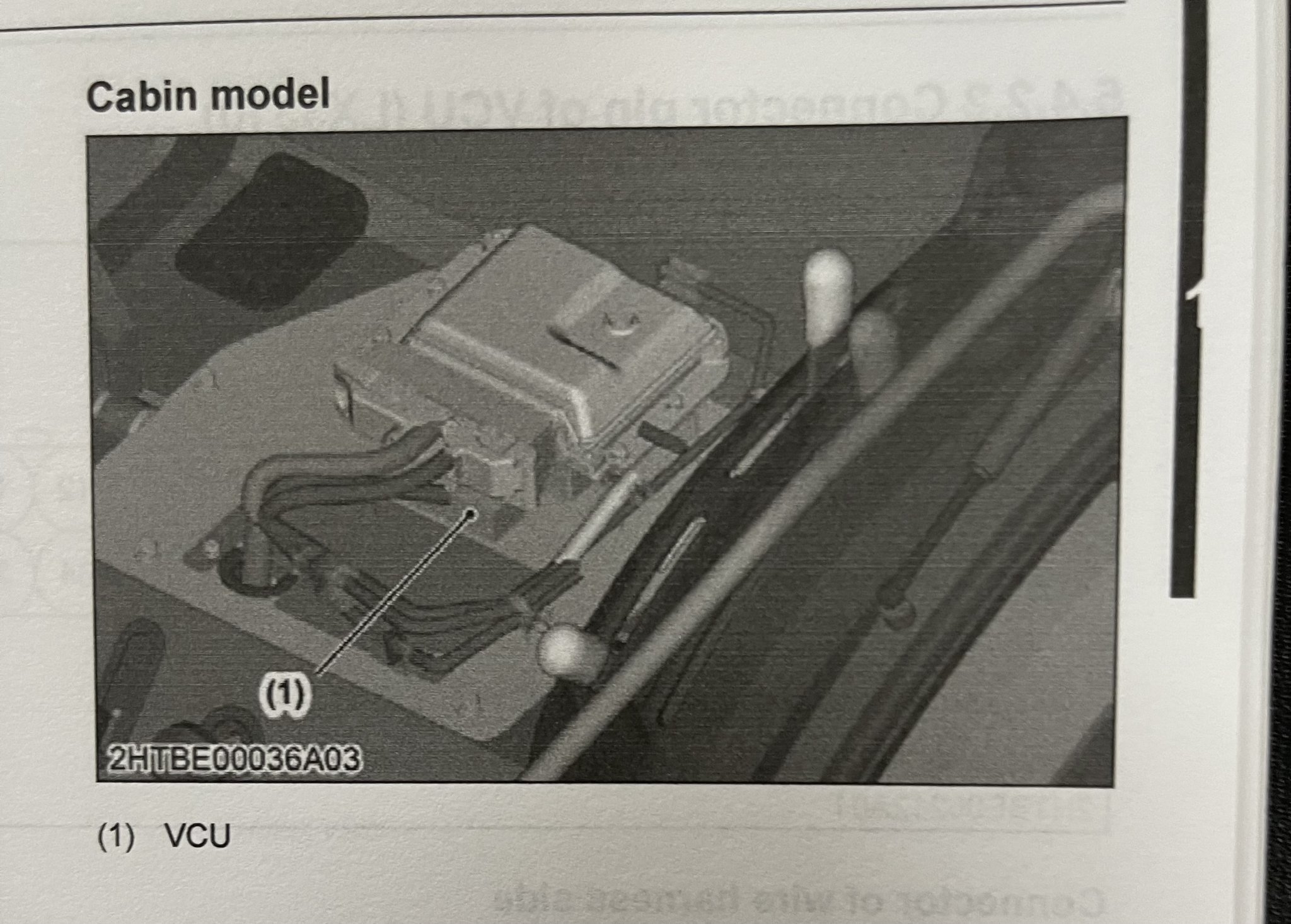

Lug66
LX2610HSDC, Z422KWT
Jun 7, 2023
116
67
SW Michigan
Here’s some LX3310 data. Depending upon your test equipment and experience level you can do Ohm, Mega-Ohm or use a Power Probe to locate the faulty circuit. I added cab and ROPs information.
