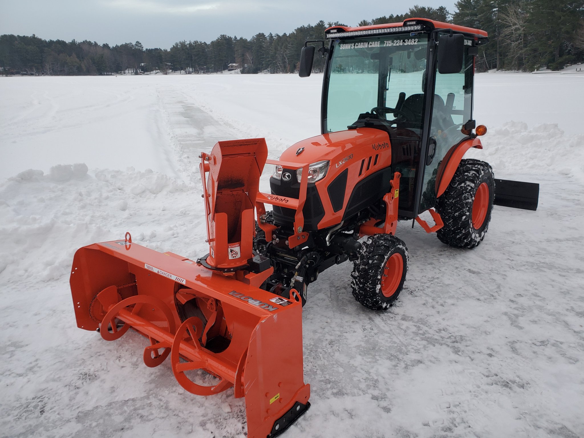

Find a new dealer. Stating the LX2980 is too much for the LX2610 is just hogwash. If it wasn't compatible with the LX2610, Kubota wouldn't offer it as an option. Period.
I bought my LX2610 tractor for commercial snow blowing of residential driveways. Last winter was my first with the tractor and the 64" blower works great. Obviously with any snowblower, ground speed needs to be adjusted for snow conditions. At no time did I feel my blower was too much for my tractor. Would I like more HP at times, of course, but the LX2610 handles it just fine.
Tell your dealer you WANT the LX2980 if that is what you can afford and desire. Walk away if he won't play along. Ever watch Gordy from GP Outdoors on YouTube? He's in Canada and has the LX2610 with the KF64 Canadian Blower. If the link doesn't work, go to GP Outdoors and look at video #342.

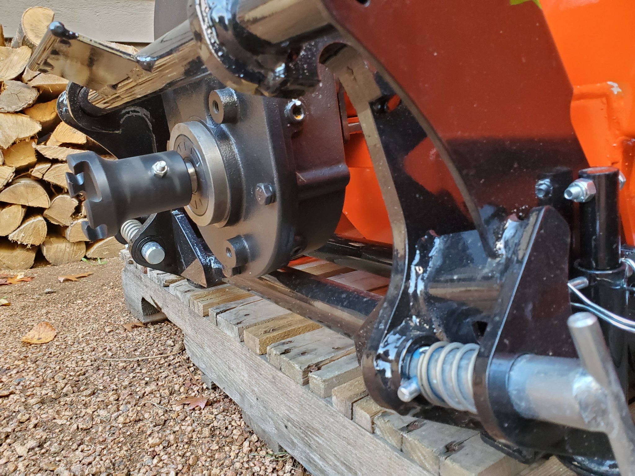

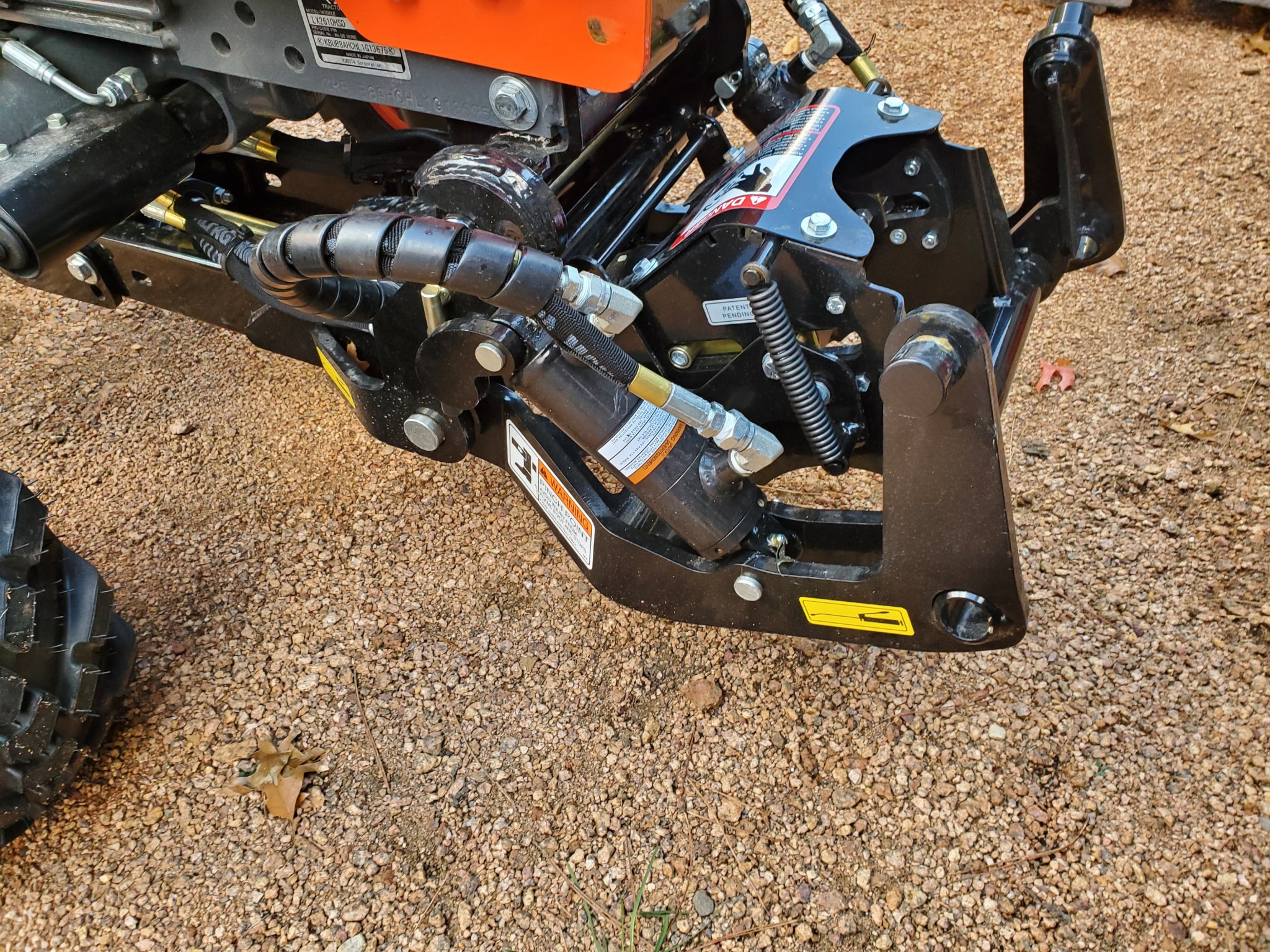

It's actually a pretty simple connection between the sub-frame and the snowblower. Note the round pin on the top right of the sub-frame and the open hole on the bottom right...
That round pin slides into the half-round in the top center of this picture of the snowblower, when lifting the sub-frame. Once that pin is seated, the spring loaded pin on the bottom right, engages in the lower hole in the sub-frame.
Hopefully these pictures help. I'd be happy to take any other pictures anyone might want.
