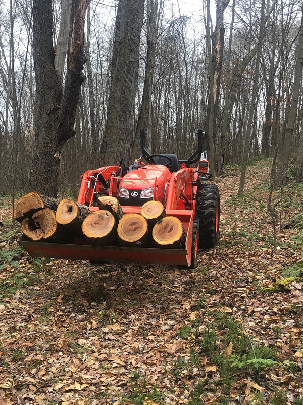

Let me ask you this, wood is seasoned and dry? and what ballast do you have? I just got my lx2610 last week and tried to lift an IBC tote with my 48-inch pallet forks with semi-green wood and no rear ballast yet. (Backhoe back-ordered for months now.)
I got it maybe 3-4" off the ground struggling, then I felt the backend of the tractor start to lift up so I just threw in the towel. Let me know your thoughts. Thanks Nick
Guys I had a B2650 (LX2610) and I wouldn't even consider lifting much of anything without rear ballast, it's hard on the front axle and more importantly dangerous when the rear wheels leave the ground.
The L2501 I have now lifts about the same as a LX2610 but is about 1,000 pounds heavier. The other day I had the ballast box on another tractor and rather than switch it thought surely the L can lift a bucket of green cherry cuts across a trail to my driveway. Well at the first small bump the back lifted, so I dumped the load and went back for the ballast box. Here's a pick of that load which isn't much.
