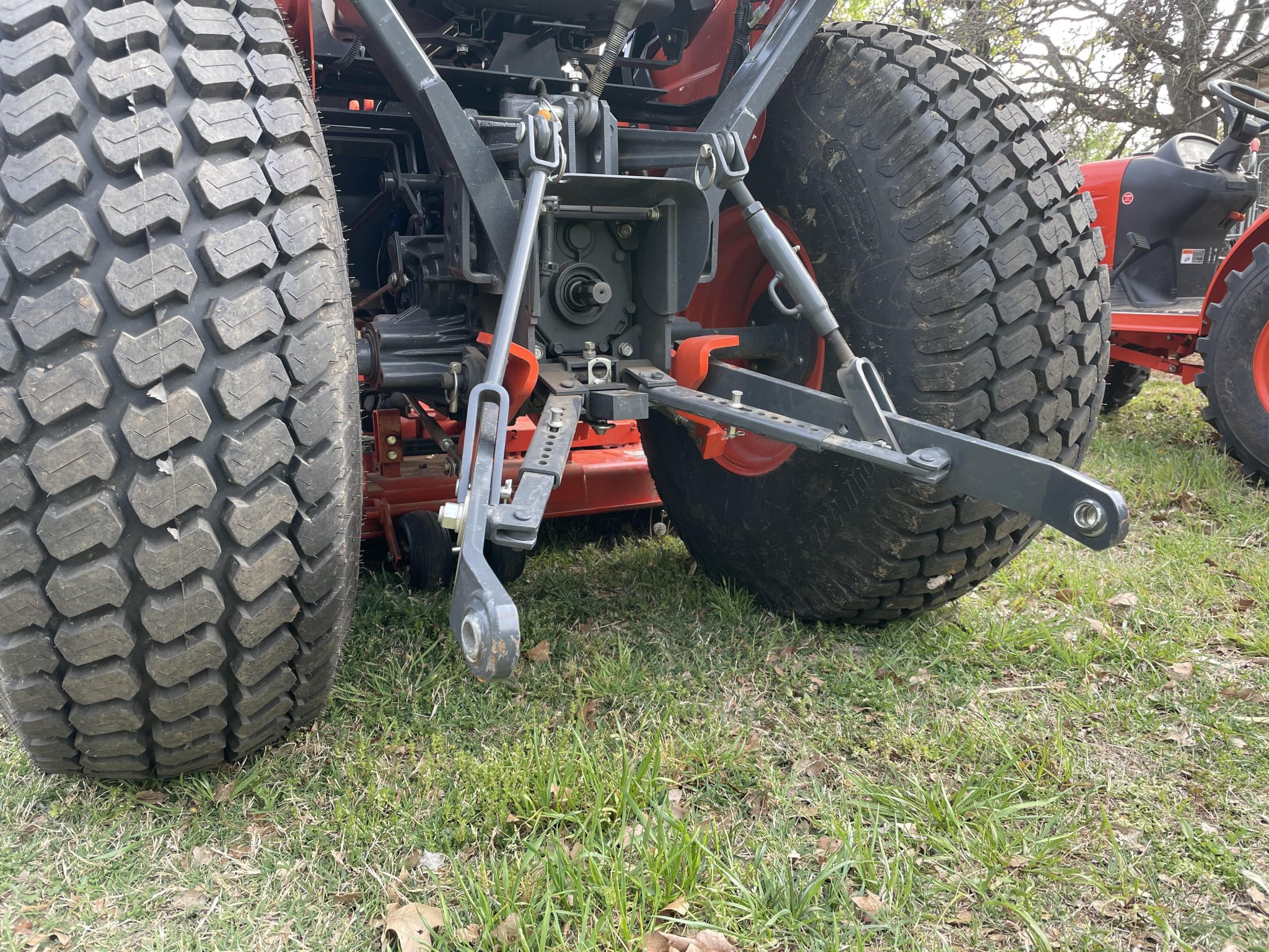

Post a picture straight from the back....betting you have 2 holes in the lower links/lift arms.
Your B2320 may have the same setup.
If you move the lift arm/side links to the hole closer to the tractor, the lift arms will go lower and higher. In doing so, you will lose some lifting power

PS - just zoomed into your picture. Move lift links back to the holes that are there..... about 3” closer to tractor from current mounting point....

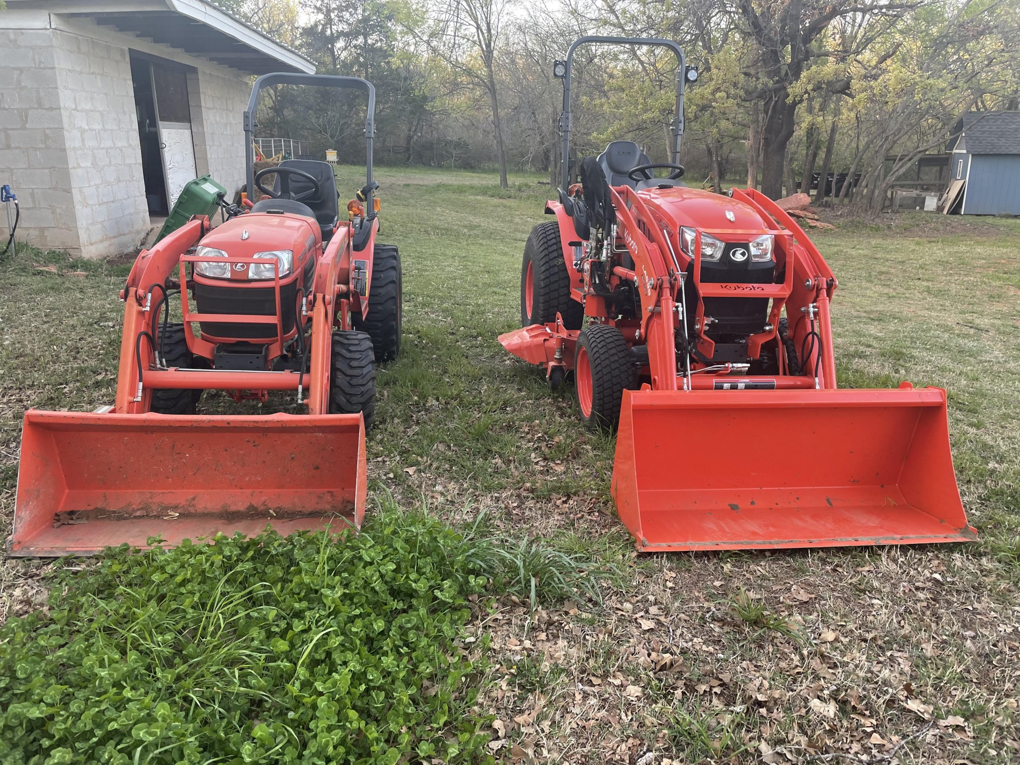

je1279, Mine is about 12" high. So I guess this normal. I am planing to add the Pat's Quick attach like I have on the b2320 which will lower it some. It just seems high.
Here is another picture. I am good with trying the closer hole on the 3 pt arm, as long as I don't mess anything up with the belly mower. 3pt.jpg 2 tractors.jpg

Your B2320 3PH is almost dragging. I would consider that abnormal versus the LX2610....
I think the LX is where is supposed to be.

Both the positioning of the lift links in the rearward holes of the three point arms and the taller turf tires are contributing to your dilemma.
I installed the optional (on ROPS models) extendable lift arm links on my B3350. These help a bit but my lift arms still do not lower sufficiently to hitch everything not blocked up.

In your opening-post you acknowledge the solution..... MOve your lift arms to the holes closer to the rear axle.
The reason it “seems to discourage it” ....is because that will reduce the amount of Weight the 3-pt can lift. But it only does so slightly, and unless you’re intending to lift the Empire State Bldg..... I doubt you’ll ever miss the lift-capacity.

Well I finally moved the lift arms to the holes closer to the axle. It lowered the three point about 3.5 inches. So now it is about 8 inches above the ground which works great with my woodland Mills stump grinder. Thanks everybody.
