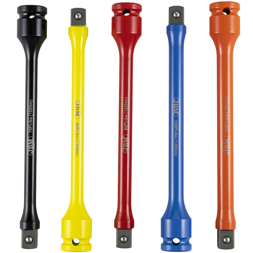

Probably in the 50 years Henro thought the techs were just guessing, some were using these and he didn't realize what they were.

As for the torque sticks, I have seen them around for years, but I don't care for them, because of reliability of accuracy. I had a set and gave them away as a result of having to go back and check with the torque wrench afterward.

Ok, I’ll bite, I’m assuming they set the proper torque, but how. Please teach me something I don’t know.

Controlled/calibrated torsion. Each stick has a specific torque value associated with it. Once the fastener has reached the target torque the torque stick absorbs the impact of the wrench preventing it from tightening the fastener any further. They work well with pneumatic guns but electrics deliver too many impacts per minute for them to work properly.

Thank you for the explanation, I’ve always used my torque wrench, first time I’ve ever seen them.

Discount Tire uses the torque-limiter adaptors on their impacts…but ALWAYS afterwards finishes the installation with a Torque Wrench. Presumably, this use of the limiters prevents the impact from over-torquing the nut…and the torque wrench establishes the specified torque.
Nice policy.
Unfortunately… the techs are not taught the PROPER USE of the Torque Wrench.
What they typically do is apply the torque wrench to the lugnut with excessive FORCE …which naturally MEETS the torque specification…but also EXCEEDS IT. Yes…the wrench will “click” …but it actually OVER-torques the lugnut by their improper technique.
Additionally, they do not support the axial-point (the socket itself) while applying the torque. This causes an INaccurate torque application because it adds radial-friction to the tool.
It meets the policy of always using a torque wrench… it just doesn’t meet the INTENT of the policy.
